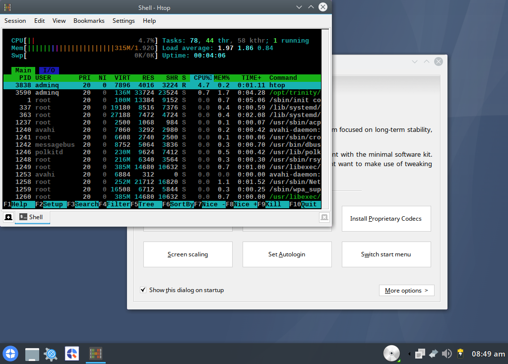

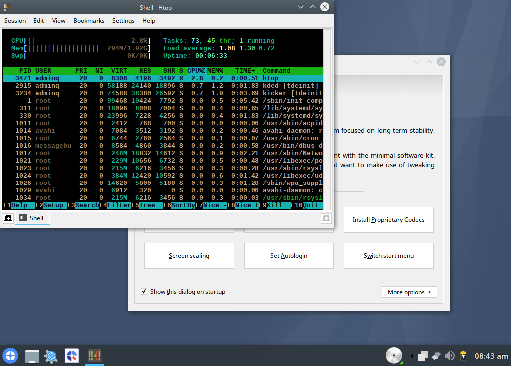

We cannot confirm that. We have performed testing in Virtualbox / 2GB RAM, started htop immediately after bootup. Htop shows the following:
q4os-4.12-x64-tde.r2.iso .. 294 MB
q4os-5.2-x64-tde.r1.iso .. 315 MB
The difference is made mostly by newer kernel, otherwise 4.12 vs 5.2 are pretty similar in set of packages and tools. Any 84% difference wouldn't make much sense.
4.12
5.2

TheScarletPimpernel wrote:
It makes me wonder if something changed with free -m and top that is being reflected in 5.12.
The new kernel uses memory in a different way, it's about caching/buffering policy. The kernel is smart enough to make use of free memory as best as possible. But using cache says nothing about the real memory requirements.
You can even see the difference of buffered memory on the images we have posted above. You get no valuable results, if you compare distros with different major kernel versions just by simple output of memory usage tools. Concluding 84% increase in ram is simply misleading.
Q4OS Aquarius isn't some more demanding on memory and hardware resources then Gemini. It's much more lightweight then any other comparable desktop distributions.
