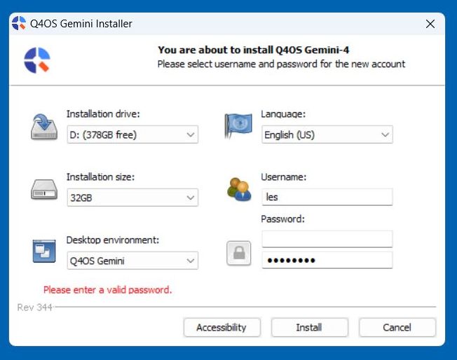

I want to run Q4OS inside Windows.
I downloaded the Q4OS windows installer.
I executed installer.
Dialog box came up.
But no matter what I enter for a password, it gets rejected with message, "Please enter a valid password".
How am I supposed to know what password to enter?
Acer Aspire 5 laptop, Windows 11 Home.
Help!

We are not able to reproduce this issue. Any password composed of latin characters should be accepted. Are you sure your keyboard layout is set correctly ? Please make a simple test and enter just single "a" character as a password and report back.

You may also need to confirm the password and enter it two times, as you can see two boxes for the password input. Both of inputs must be identical.
There is no place to enter the password twice in the initial Windows installer dialog box.

I see it!  Never mind.
