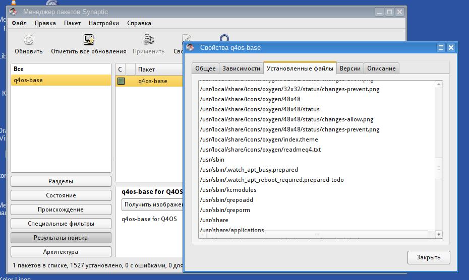

In fact, in addition to empty files / directories, rkhunter swears at two hidden executable files from the package  q4os-base.
But, probably it should be so.

aluma wrote:
.. rkhunter swears at two hidden executable files from the package  q4os-base.
Which files ? What does it report exactly ?
#6 2021-05-09 17:04
aluma
From: Ukraine
Registered: 2018-03-12
Posts: 136
Re: Warning rootkit.
I posted it in the first post, this is from the log rkhunter:
"[09:37:54] Warning: Hidden file found: /usr/sbin/.watch_apt_busy.prepared: POSIX shell script, ASCII text executable
[09:37:54] Warning: Hidden file found: /usr/sbin/.watch_apt_reboot_required.prepared-todo: POSIX shell script, ASCII text executable"."
/usr/sbin/.watch_apt_busy.prepared,  /usr/sbin/.watch_apt_reboot_required.prepared-todo - files q4os-base.
#7 2021-05-09 19:00
Posts: 4,230
Well, we see now. These files are just short shell script, you can edit them and view the code, nothing dubious. In anyway, we will move them to a more proper location, thanks for reporting.
