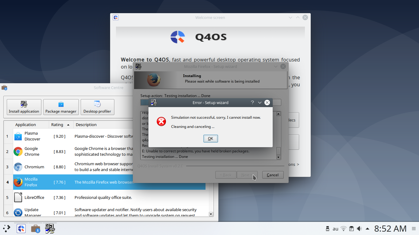

Apps not installing " Simulation not successful .."
Tried installing Firefox and Chromium from the Software Centre but got following error message:
"Simulation not successful, sorry, I cannot install now.
"Cleaning and canceling ..."
Had previously installed Palemoon and a couple of other apps so this is a new one. Will wait for instructions on what report to generate rather than guessing. I did take a look online for that error message but the only thing that came up (DDG or Google) was one earlier post here, and then only for a download - couldn't access the post it came from, see:
https://www.google.com/url?sa=t&rct=j&q … WaN2_rmO2t
Sorry, haven't installed a URL bumf stripper in Palemoon yet wink

Please run in terminal:
$ reportq4
and send the debug file generated via email support@q4os.org , or attach it here for us to analyze.

Thanks for the debug file, you sent. We have examined the logs and found two different errors. The first is about "grub-pc" bug https://sourceforge.net/p/q4os/tickets/148/ , which is resolved at present, so desktop profiler should work fine now, as we can see from the log files.
The second error is about unresolved dependencies throughout Chromium installation. As you have added some alien repositories, what is not recommended, we are suspecting them from causing the failing installation.
deb [trusted=yes] file:/var/opt/amdgpu-pro-local/ ./
deb http://ppa.launchpad.net/mumble/release/ubuntu hirsute main
Please remove them and try to run Chromium installation again. If the installation fails, run in terminal:
$ sudo apt update
$ sudo apt install q4os-chromium
and report back please.
