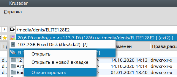

[Solved] Krusader refuses to unmount removable device.
This is probably a bug in Krusader.

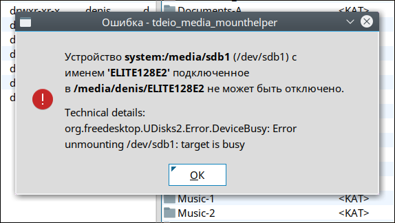

When you mount a removable drive, then try to unmount (attachment 1), system returns an error, even if there is nothing has been copied to the device. (attachment 2)

You need to go away from the mounted media subdirectory in Krusader as well as other file managers to be able to unmount the device. While you have a mounted subdirectory opened in any way, you will not be allowed to unmount it, as it's still active and might not be synchronized.
