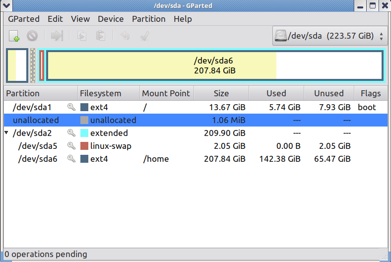

The best way to future proof and allow you to move around between different distros and or versions is based on your drive being correctly partitioned so that the OS and your data are separated.
The way I have always done this and it has seen me through countless distro hops is to set up as follows
1. Boot + OS in Primary partition sda1 /
2. Extended partition for rest of space on drive
3. In that space small logical drive for swap - say 4gb
4. Remainder of logical space for /home
When you install a new version you can then just tell it to re-use the /home partition and away you go. Having said that I always make sure that I have a backup!
Attached shows drive setup in gparted if it's useful. You also need to consider the impact of the various config and other dot files in your home area. These are related to both your interface/desktop and also apps that have been installed over the years. These days installers are pretty well behaved but in the past I came across some that would would cause problems if they found a user space already set up on a drive in the same name as the one to be used in the new install. Configs would not be set correctly etc etc. So I still tend to just rename my current /home (again from the live media) and then just move stuff across once the new system has been set up.
