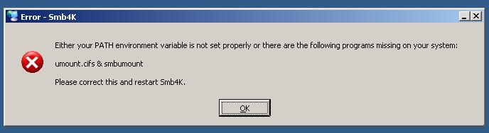

Wanted to transfer a load of music from my winbox so thought I would install Smb4k Trinity
It fails with error in screen grab
I have tried adding /sbin to my /etc/environment
mount.cifs does actually exist in /sbin
what gives?

Hang on its asking for umount.cifs not mount.cifs - in which case it actually does not exist?
I noticed samba-common was installed but not samba - so I installed that but still no umount.cifs
Is this deprecated or something?

Yes, we are able to reproduce that, "smb4k-trinity" doesn't work. We can recommend you to use "smb4k" package instead. We will check the issue and possibly create a new bug report at the Trinity site.
#4 2019-06-16 21:24
Posts: 6,316
Re: SMB4K Error
As the bug report exists yet, we haven't created a new, but confirmed the existing one, please see https://bugs.trinitydesktop.org/show_bug.cgi?id=1024
