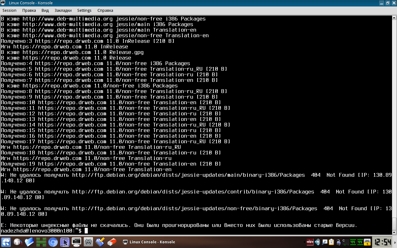

On my old good Lenovo 3000 N100 notebook I still have Q4OS 1.8.10-n1 Orion installed.
The problem is, that some packages does not updating through repositories. For instance packages from jessie-backports are not available at all. So, I disabled jessie-backports repository.
And some packages from jessie-updates are not available (screenshot). Is it normal?

Re: Q4OS Orion updates.
I think this is normal, if you read the link I'm posting it should help, as you will see (near the bottom) you can use the archive repository.
https://www.lucas-nussbaum.net/blog/?p=947
Thank you, Dai_trying!
So, I should remove jessie-updates and jessie-backports from /etc/apt/sources.list and add
deb http://deb.debian.org/debian/ jessie main contrib non-free
deb-src http://deb.debian.org/debian/ jessie main contrib non-free
deb http://security.debian.org/ jessie/updates main contrib non-free
deb-src http://security.debian.org/ jessie/updates main contrib non-free
as described here https://wiki.debian.org/LTS/Using if I want to recieve updates till 2020-06-30?
On that notebook I do not need jessie-backports.
Yes I think that should work ok but I don't have an old installation to try it.

You can update sources list manually, or it's possible to run following commands for automatic setup:
$ sudo apt-get update
$ sudo apt-get install q4os-base
$ sudo apt-get dist-upgrade

If Q4OS Orion was freshly installed and the following commands were run (as shown in q4osteam post above):
Would this allow immediate access and installation of all Debian 8 updates (regular and extended-support)? Thank you.
#7 2019-04-02 20:32
Posts: 6,111
Yes, Debian repositories will be configured as described here https://wiki.debian.org/LTS/Using . You can check that using command:
$ qrepolist
