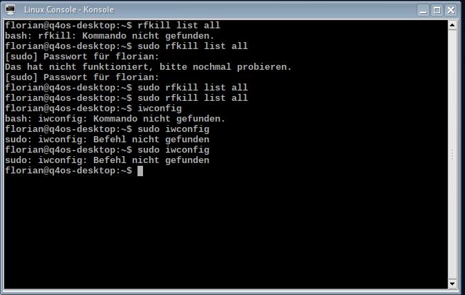

Taking the last question first - iwconfig and rfkill require the use of sudo - see below.

Concernig  sudo rfkill, l will attach a screenshot showing me fighting with the console. Please note that I try it without and then with sudo. After entering a wrong password intentionally, I insert the correct one afterwards. Then 2 times "sudo rfkill list all" without getting any list out. Same story with iwconfig, it just throws out "command unknown" or "Befehl nicht gefunden" in German...
Concerning Fn F2 and locking/unlocking the WiFi via seperate switch on the laptop: no effects at all. WiFi never worked as Q4OS is not able to identify ANY Wifi hardware installed to my laptop.I am connected now via LAN, which works good but I want to use the WiFi card which worked 10 years under Vista.
