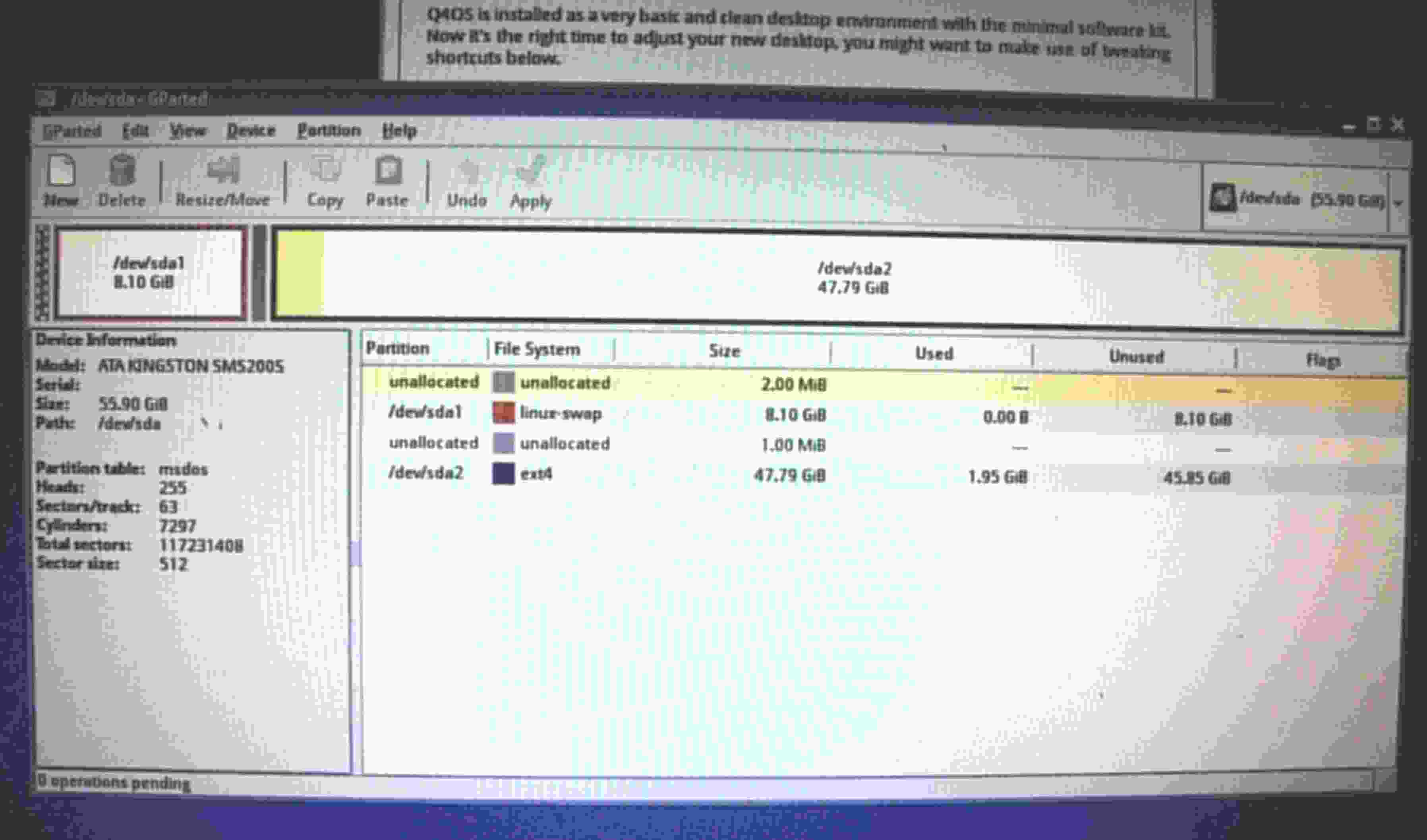

#17 2018-10-05 12:42
ChasG
Registered: 2018-10-05
Posts: 11
Re: OPERATING SYSTEM NOT FOUND - After Fresh Install
Trial is not on a connected unit. In a different room!
ran Sudo etc so took photo ,
Looks like installer has not made a bootable SSD?
C+
#18 2018-10-05 12:49
ChasG
Posts: 11
Used your sudo*
trial is in another room and unconnected so took photo
looks like installer failed to make a bootable SSD
#19 2018-10-05 13:10
Posts: 6,437
Well done, now try to create the boot flag on /dev/sda2:
Run GParted > right mouse click on the /dev/sda2... line in the GP window > Manage flags > check "boot" box > Close > Try to reboot installed OS
Post back the result.
