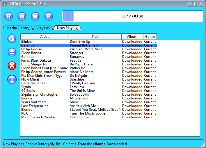

P.s. If anyone is interested I have attached a current screenshot of it working. smile
