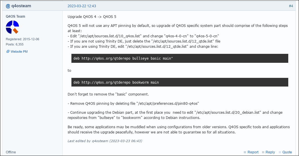

I know that there has been a lot on this topic. I normally do a clean install of Q4os, but this time I decided to do an in place upgrade from Gemini to Acquarius unti the next time there is a major LTS (beyond Andromeda I followed the instructions on the attached screenshot from the Q4os team (l
