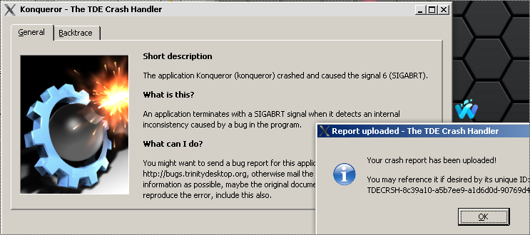

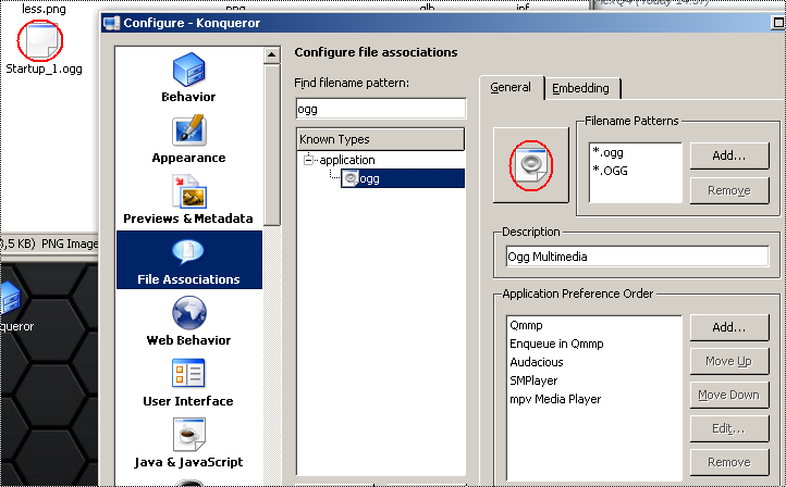

#32 2026-03-10 14:20
Posts: 274
Re: Q4OS TDE: acoustic (ogg) System Notifications fail
So i went to /opt/trinity/share/sounds again and observed, that the ogg-files have an 'empty' file icon (withaout a loudspeaker, like the wav) - See the first two snapshots attached.
Thought: maybe here's something missing and decided to add the 'missing' ogg filetype 'Ogg File' selected the appropriate icon, and 'artsplay' as application.
That was a mistake! Now booting up, it is waiting first several seconds at the (5th) Desktop Icon, and then com several error massage boxes "Sorry - KDesktop: Could not find mimetype  application octet-strem'
These messages do occur also subsequently opening konqueror or any other k-app (see snaphot 3).
It's not possible to start (double-click) the 'Control Panel' any more, even worse: it crahes (-> snapshot 4).
However, i can start 'tdecmshell kcmnotify' from the console.
Ok, max of uploades reached, i'll start a new post...
#33 2026-03-10 14:42
Posts: 274
I would like to mention, that every other non-k app is still workin withot any issue.
Long story short: Is it possible to
A)  reset TDE's mime-database,  or
B)  copy/transfer it from a fine (backup) installation/disk,  or
C)  correct it manually
Thank you!
Edit: or maybe i should go to https://www.trinitydesktop.org/ and ask there?
Edit2: Added a last snaphot.

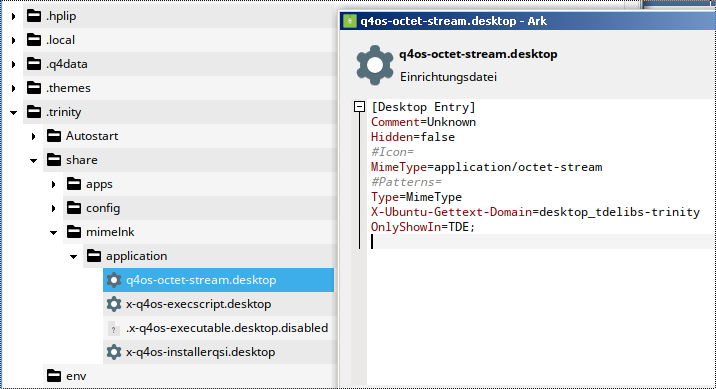

#41 2026-03-11 12:49
Posts: 6,442
FlexQ4 wrote:
The 'ogg' patterns in the first (q4os-octet-stream.desktop) seem somewhat strange?
Yes, it's not the original file intended to depreciate the "octet-stream" bug, so something had to rewrite this file. The original you will find in:
/usr/share/apps/q4os_system/share/q4os_home.tar.gz/.trinity/share/mimelnk/application/q4os-octet-stream.desktop
What happens, if you delete your fix "$HOME/.trinity/share/mimelnk/application/octet-stream.desktop", and rewrite q4os-octet-stream.desktop back with its original, so it should be:
[Desktop Entry]
#defines mime type, the same as /usr/share/mime/packages/*.desktop
#override the default trinity octet-stream mimetype
Comment=Unknown
#Icon=
MimeType=application/octet-stream
#X-TDE-PatternsAccuracy=0
#Patterns=
Type=MimeType
OnlyShowIn=TDE;
X-Ubuntu-Gettext-Domain=desktop_tdelibs-trinity
The original looks a bit different here: Not possible to copy&paste from ark-preview, so please see screenshot.
I will now save the current q4os-octet-stream.desktop and unpack the original from q4os_home.tar.gz.

#43 2026-03-11 15:11
Posts: 6,442
We are now confused about what works and what doesn’t. Could you please post a few combinations here along with results ?
1.
q4os-octet-stream.desktop / A
octet-stream.desktop - present
result: ??
2.
octet-stream.desktop - deleted
result: ??
3.
q4os-octet-stream.desktop / B
result: ??
4.
result: ??
q4os-octet-stream.desktop / A ... weird version with .ogg reference inside
q4os-octet-stream.desktop / B ... original version extracted from the tgz archive
Don't forget re-login between the tests.
#44 2026-03-11 16:01
Posts: 274
Regarding ~/.trinity/share/mimelnk/application/q4os-octet-stream.desktop:
1) The ,crossover' version which i have/had:
[Desktop Entry]
Comment=Ogg File
Hidden=true
Icon=audio-x-generic
MimeType=application/x-kdeuser2
OnlyShowIn=TDE;
Patterns=*.ogg;*.OGG
Type=MimeType
-> Works!
2) the ,origial' version of  /usr/share/apps/q4os_system/share/q4os_home.tar.gz (date: 10.10.2001):
[Desktop Entry]
Comment=Unknown
Hidden=false
#Icon=
#Patterns=
Type=MimeType
OnlyShowIn=TDE;
-> The ogg-issue in TDE is back!
3) The version which you posted in #41 - which differes slightly from the version in q4os_home.tar.gz:
[Desktop Entry]
Comment=Unknown
#Icon=
#Patterns=
Type=MimeType
OnlyShowIn=TDE;
-> The ogg-issue in TDE is still there!
4) Reverted back to 1) -> It's working fine again!
Each time i changed q4os-octet-stream.desktop, i rebooted!!

And since it looks much better for me than the quirky 'mixture octet-stream+ogg' crossover version,
i'll leave it that way! Many Thanks!!

#47 2026-03-11 17:17
Posts: 6,442
Perfect. If you would get any new info about how "q4os-octet-stream.desktop" might have changed, do not hesitate to post here.
Another odd thing is that your "/usr/share/apps/q4os_system/share/q4os_home.tar.gz" file is not the current one as it should be. Do you have your system up to date ?
