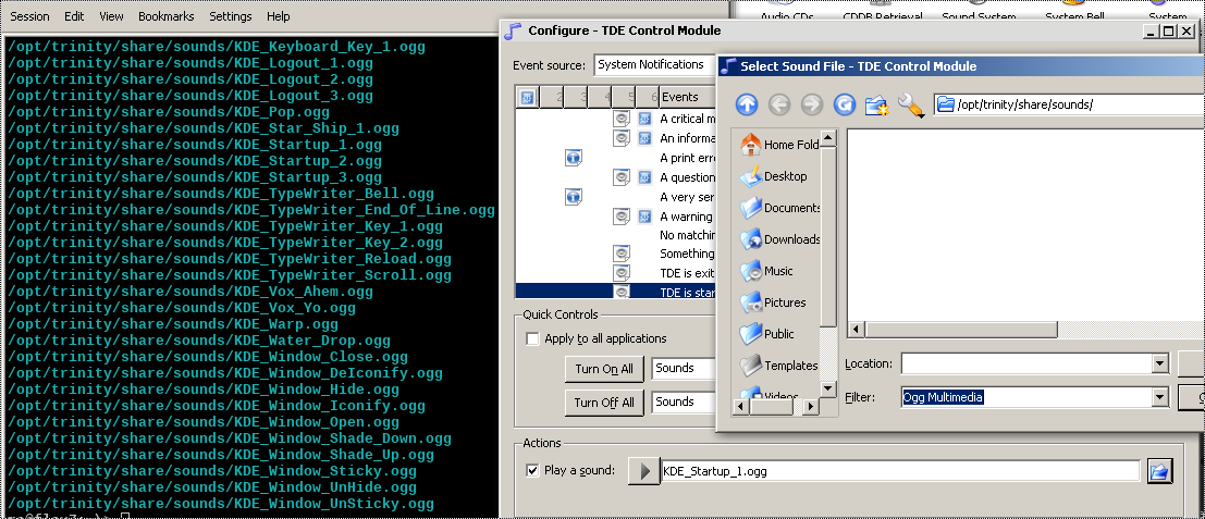

[Control Panel] -> [Sound & Multimedia] -> [System Notifications]:
it has lost its "ogg-capabilities completely: neither can it play the KDE_Error_1.ogg, nor are the ogg-files (in /opt/trinity/share/sounds) shown in the open file dialog.
if i select filter "Ogg Multimedia" -> no files are shown!

#3 2026-03-03 22:09
Posts: 274
Re: Q4OS TDE: acoustic (ogg) System Notifications fail
Hello!
Do you have .ogg files in the /opt/trinity/share/sounds/ folder ?
YES, they are all there!!
Run in terminal and post the output:
$ ls -1 /opt/trinity/share/sounds/ | grep KDE_Startup_1.ogg
~\> ls -1 /opt/trinity/share/sounds/ | grep KDE_Startup_1.ogg
KDE_Startup_1.ogg
$ dpkg -S /opt/trinity/share/sounds/KDE_Startup_1.ogg
~\> dpkg -S /opt/trinity/share/sounds/KDE_Startup_1.ogg
tdebase-data-trinity: /opt/trinity/share/sounds/KDE_Startup_1.ogg
What is really weird: if i start 'Sound System' of the Control panel an click on [Test sound], the welcome sound is playing!
If i go to [System Notifications] again, click on the 'Open file dialog' (right to the KDE_Error_1.ogg) and select the filter 'Ogg Multimedia': no files are shown!
That is absolutely amazing and annoying.

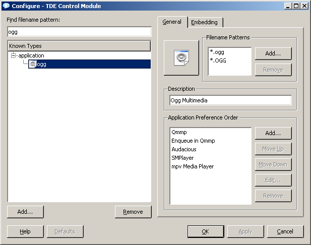

#5 2026-03-03 23:16
Posts: 274
I would say: a mismatch of filetype of 'Ogg Multimedia" in the TDE Control Module.
See attached hardcopy:

4. Check Trinity MIME configuration
Trinity keeps its own MIME settings.
Open:
Control Panel → File Associations
Search for:
ogg
You should see something like:
audio/x-vorbis+ogg
audio/ogg
If missing, the file dialog filter will fail exactly like shown.

Many thanks! I'm currently at
4. Check Trinity MIME configuration, Trinity keeps its own MIME settings.
Open:
Search for:
ogg
audio/x-vorbis+ogg
audio/ogg
Here i have only - see below - is there missing something?
Edit: No, exactly the same as on the ,ogg-functional' backup-system. Continuing...
#13 2026-03-05 14:45
Posts: 6,442
That looks fine. We have the same at the testing computer and .ogg files are visible in TDE.

Before trying C (Reinstall MIME packages) i'd like to ask a question:
How can it be that  Control panel -> Sound System  works fine playing the welcome-ogg, and -> System Notification fails?
They are both TDE Control modules!?
Where ist the binary/executable of 'System Notification' located, could it be re-installed?
-> Lately i mounted a partition (data exchange with Windows) and it was mounted as Read only. And i did not touch that value!
So, at the moment - unfortunately - i would not exclude an ssd-hardware malfunction...
Edit: But since others had this strange effect too, it is highly unlikely...

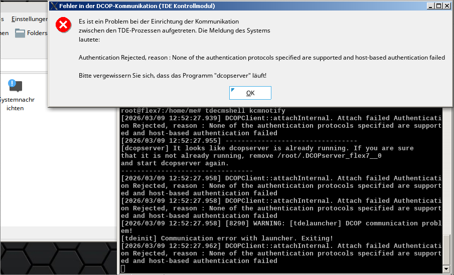

#21 2026-03-09 13:12
Posts: 274
i had the idea to start "tdecmshell kcmnotify" as root.
Please see the screencopy attached for the bunch of (error)messages that are given out - i also translate the (german) messages in the dialog box:
Error in the DCOM-Communication (KCE Controlmodule)
- A problem occured while establishing the communication between TDE processes
  reason : None of the authentication protocols specified are supported and host-based authentication failed
- Plese ensure, that the program "dcopserver" is running

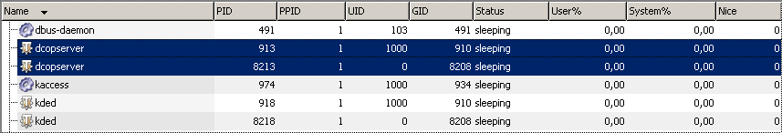

#22 2026-03-09 13:23
Posts: 274
KSysGuard shows, that there are 2 dcopserver processes running, see attachment.
#23 2026-03-09 13:23
Posts: 6,442
Well, try to run in terminal:
$ tdebuildsycoca
$ sudo tdebuildsycoca
$ sudo tdecmshell kcmnotify
and post back the output and results.
#24 2026-03-09 13:44
Posts: 6,442
FlexQ4 wrote:
KSysGuard shows, that there are 2 dcopserver processes running ...
Yes, that's correct. One for user and the second for root.
