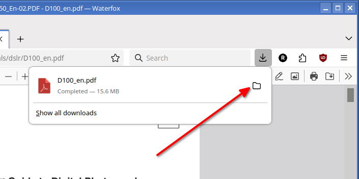

This is an old problem which I thought had been overcome in the past.
I know it is xdg related but cannot get any further.
Using browser download e.g. a PDF but can be anything.
The icon on the toolbar shows it has finished.
Click the icon and then the folder icon to open the destination folder.
In Waterfox the process does nothing.
In Firefox-esr likewise nothing.
In Chromium this brings up a box saying it cannot find any software to do that - click cancel and it opens the folder.
All three work as expected in Plasma.

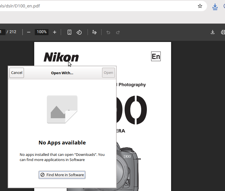

Fresh install Desktop Profile - then installed Multimedia Codecs (sorry it's just muscle memory)
Open Chromium.
Go to a downloadable item and download.
Click the folder icon and brings up the 'No software available' box as illustrated.
Click Cancel and it takes you to the download location in Konqueror.

1. *fox: It's clear upstream bug.
2. Chromium:
... Go to a downloadable item and download. ... Click the folder icon and brings up the 'No software available' box as illustrated.
Please specify the link for us to be able to reproduce.
... brings up the 'No software available' box as illustrated.
Where is it ilustrated ?
https://sourceforge.net/projects/q4os/f … t/download
https://cdn-10.nikon-cdn.com/pdf/manual … 100_en.pdf
http://ftp.de.debian.org/debian/pool/ma … _amd64.deb
Chromium: We've got it and we are able to reproduce now. We will investigate and post back.
A workaround for Chromium is to remove the "xdg-desktop-portal-gtk" package. We are still investigating the issue and will provide an update as soon as new information becomes available.
Thank you - that does work.
