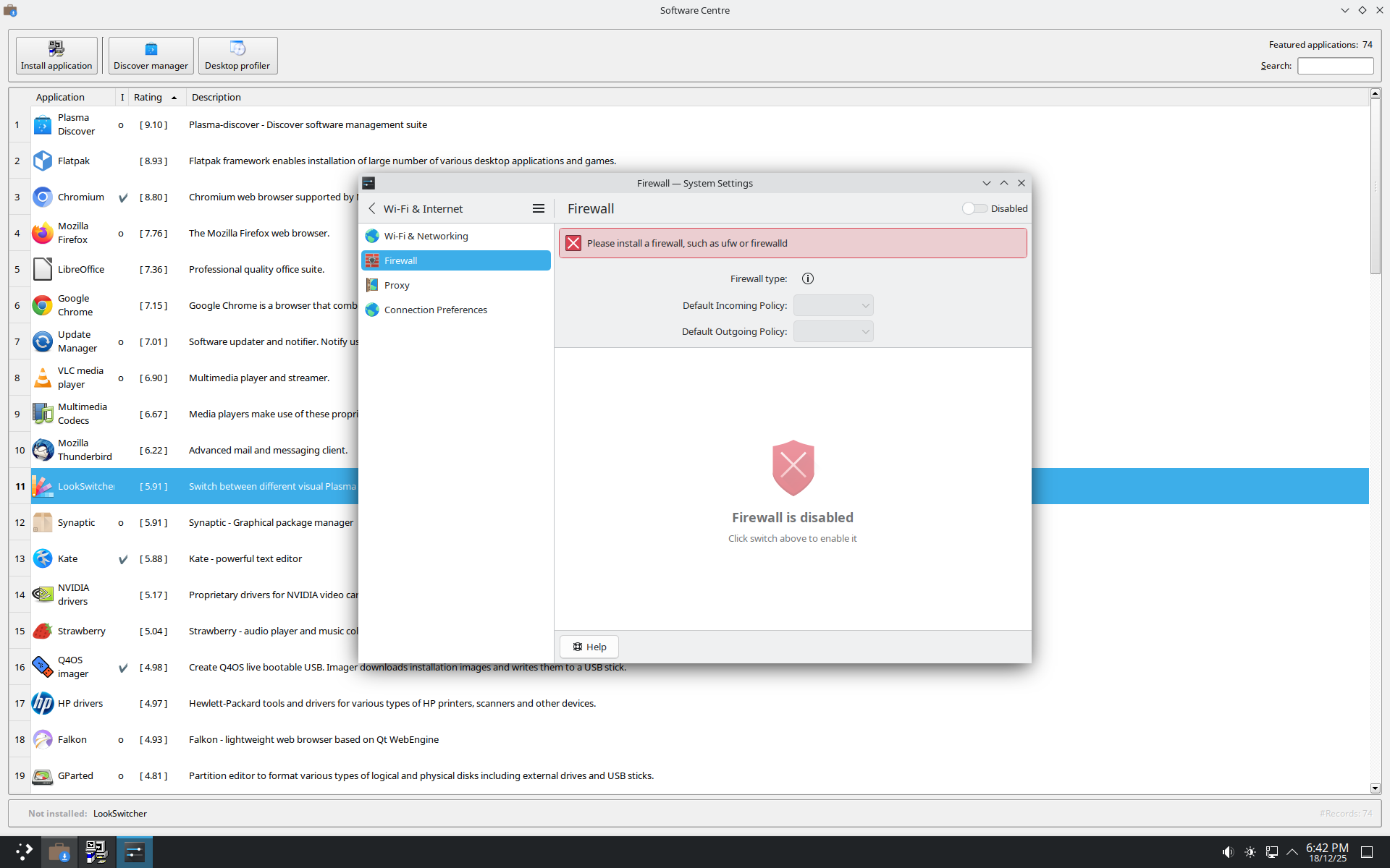

That is not the case in my situation.
Straight standard install
I checked to see if a firewall was installed --- but this is the result.
As you can see the system is asking me to install a firewall.
Which is what I did.
Cheers
Q
What desktop profile did you apply ? You may only need to install "ufw" or "firewalld" package.

I applied the 'live' setup that replicates what a live user will see.
It's a bit odd.
Anyway - a few minutes ago I manually removed the gufw program.
Rebooted and viola -- the firewall is now switched on and active.
I am not meaning to cause any problems - been using Q4OS since the early days.
It's odd - but probably a mistake I have made somehow and not the system.
Thanks for looking over it.
Q

We recommend you rather to apply Basic profile instead of Live. It will configure your system the similar way, but better. It will also remove some useless packages, what are needed only for live media.
Firewall is not part of the Live nor Basic install. Once you would install the Desktop profile, you would get full system with firewall installed.
It's not odd. Since you installed Gufw, it pulled "ufw" package as a dependency, so now the system settings module has all the needed. If you remove Gufw, the "ufw" package keeps installed as a dependency of the Plasma Firewall module. However it's optional - you may choose between "ufw" and "firewalld".
