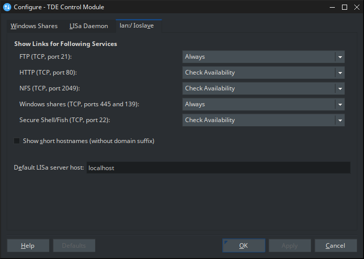

It is recommended to Always Show Links For Windows shares

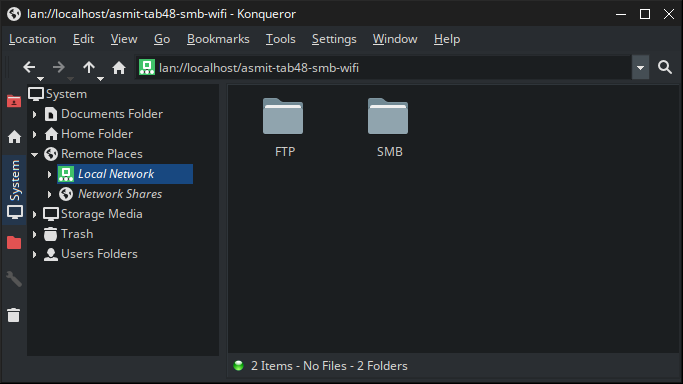

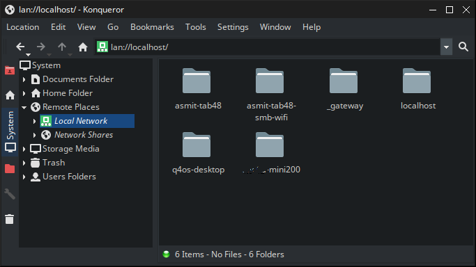

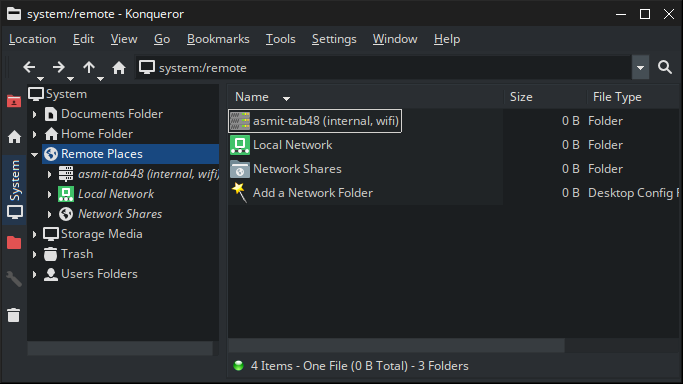

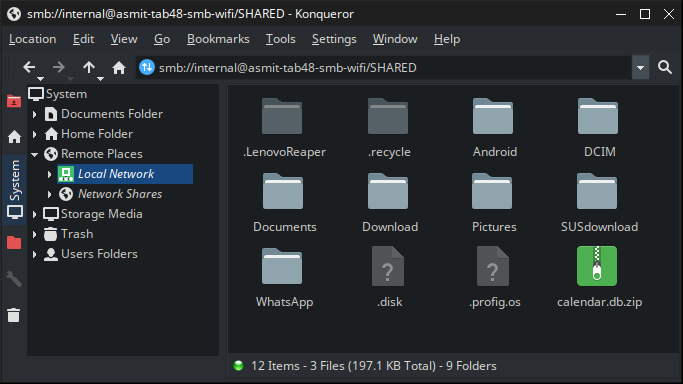

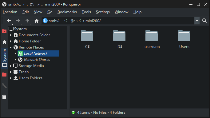

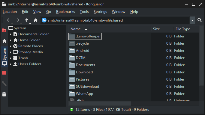

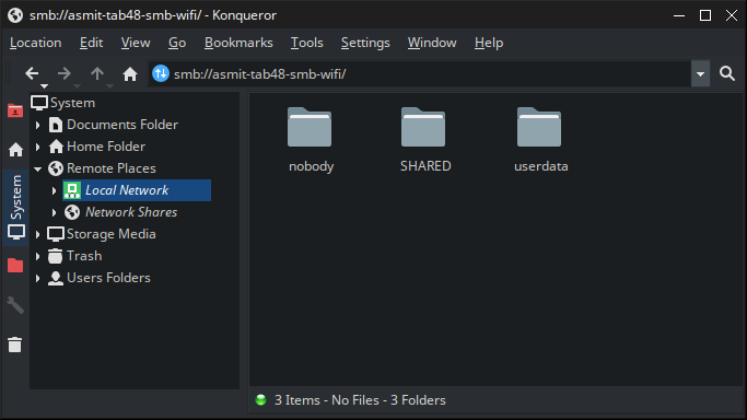

Here, q4os-desktop and localhost is your computer. asmit-tab48 is android on 192.168.43.243:1445, which konqueror does not support. asmit-tab48-smb-wifi is 127.0.0.2:445 which is proxied 192.168.43.243:1445. -mini200 is a windows-7 device.

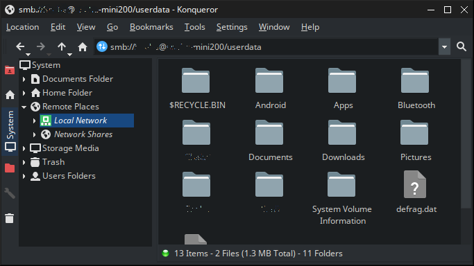

Browsing the windows device:
_______________________
Browsing the android device:
_________________________________________________________________________________________________________________________

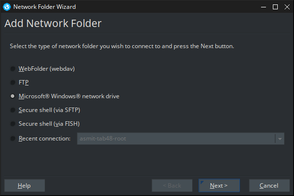

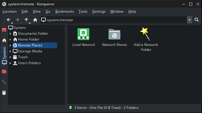

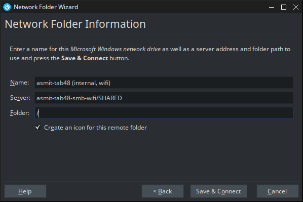

It is recommended to Add a Network Folder, because LISa sometimes does not show all the folders in lan:// but they are accessible non the less.
