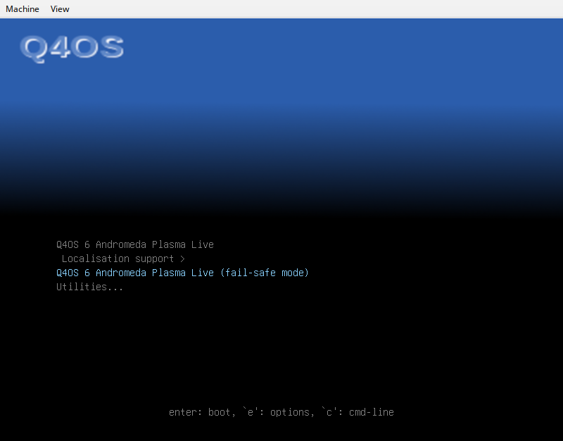

As a first attempt, please boot the default Q4OS 6.2 Plasma https://www.q4os.org/redirect08.html . On the initial boot screen, select the third option "Q4OS 6 Plasma live (fail-save mode)", let the system boot for a while, and then post a screenshot of what you see on the screen, if some messages are present.

Re: 6.1 Q4OS Install with Nvidia GPU - No Video Output To Complete Instal
On screen output:
EFI Stub: Loaded inited from Linux_EFI_INITRD_MEDIA_GUID device path
EFI Stub: Measured initrd data into PCR 9
Hope this is of some value.

#23 2025-11-04 17:36
Posts: 6,376
Well, we have compiled the first experimental live media. It's very close to the vanilla Debian 13 Plasma live, but with a few slight modifications. Download "q4os-x64-experimental-rb001.iso" here https://sourceforge.net/projects/q4os/files/testing/ , give it a boot and post the result please.
md5sum:
