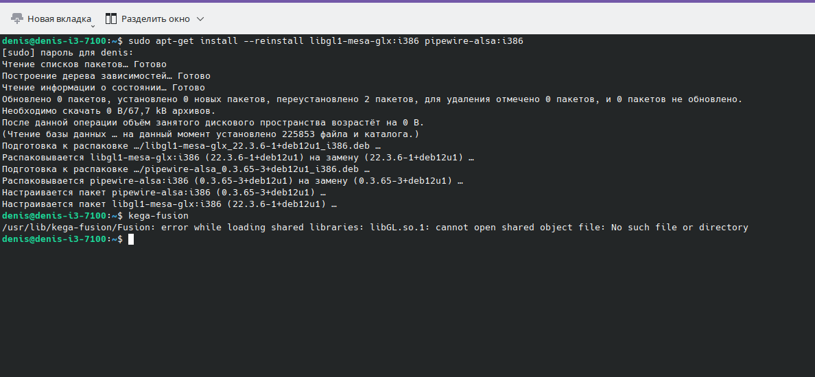

I have installed it using the following commands:
sudo dpkg --add-architecture i386
sudo apt update
sudo apt update && sudo apt full-upgrade
sudo apt-get install --reinstall libgl1-mesa-glx:i386 pipewire-alsa:i386
sudo apt install /home/denis/Kega/kega-fusion_3.63-2_i386.deb

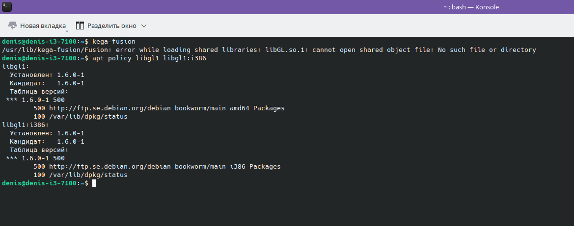

But, when I try to run it, I have always got an error:
/usr/lib/kega-fusion/Fusion: error while loading shared libraries: libGL.so.1: cannot open shared object file: No such file or directory
But why? I have libgl1:i386 installed properly. See attachments.
Please help. On Linux Mint everything worked well...

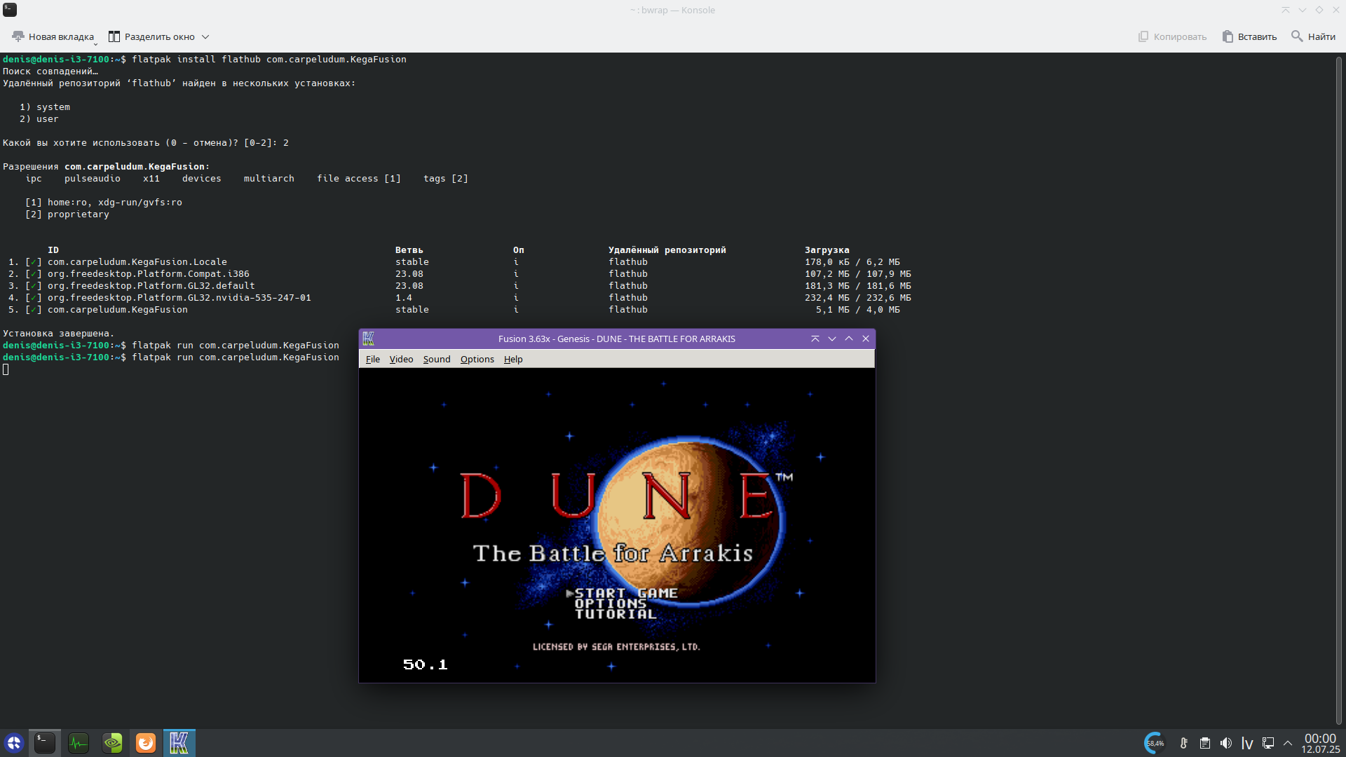

Anyway, I have installed KegaFusion from Flathub: https://flathub.org/apps/com.carpeludum.KegaFusion
Flatpak version works very well! So this problem is solved.
P.s. Look at time on the screenshot!

Glad you got it working and many times Flatpaks can solve issues as they contain everything thats needed and usually are up to date.
