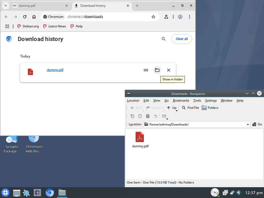

We are not able to reproduce the issue, Chromium works as expected here.
- Loaded the most recent Q4OS 6 Trinity alpha iso q4os-6.0-x64-trinity.r5-testing-alpha.iso
- Installed Synaptic from Software center, Mc from terminal, Chromium from the Software center
- Ran Chromium, open dummy pdf https://www.w3.org/WAI/ER/tests/xhtml/t … /dummy.pdf
- Saved dummy.pdf to Downloads folder
- Open Chromium downloads tool and command dummy pdf to "show in folder"
- Trinity Konqueror windows opens properly
Are you able to reproduce the issue with this dummy pdf ? What is the exact link, or what are you doing differently ?

We are still unable to get the error, the button works too. Maybe some specific link triggers the issue ? Are you able to reproduce the issue with dummy pdf ? https://www.w3.org/WAI/ER/tests/xhtml/t … /dummy.pdf
