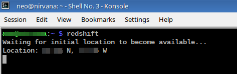

As for redshift, I'm honestly at a loss at this point. I don't know what I'm doing wrong but initially, it was complaining about geoclue and Wayland not being found but eventually I discovered how to force redshift to use manual method and randr but now even with those errors gone, I still see attached screenshot.
The screenshot shows the correct message, it should be ok. Now you only need to run "redshift-gtk" and see it in system tray. Don't install any of "*wayland*" packages, they are not needed. Redshift falls back to the "randr" method.
