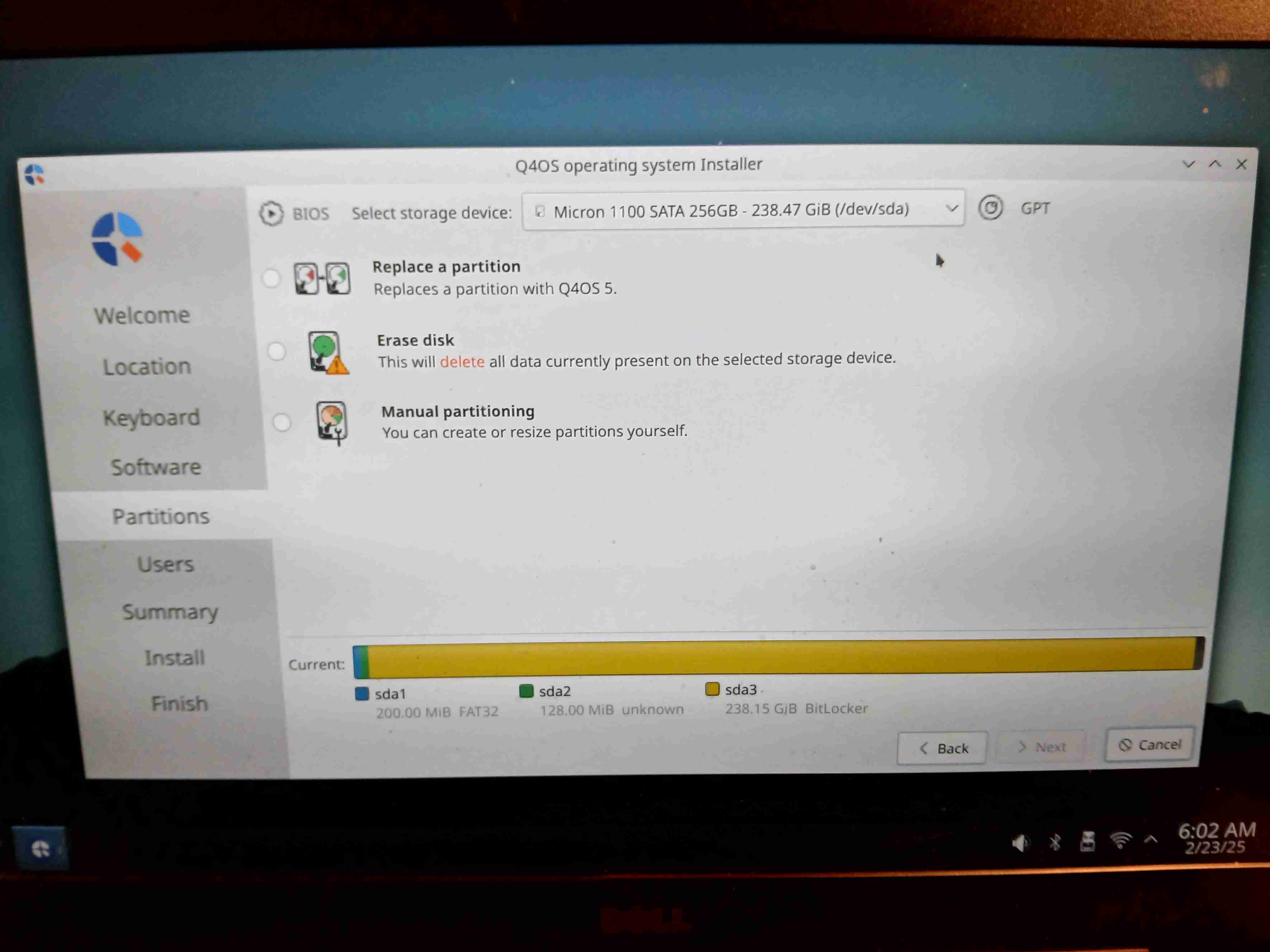

I don't have an "Install Alongside" option! That would have made a big difference for my installation! I don't know why it was not included in my Live distribution. Maybe I need to get the regular installer, not the live one?

Re: can't reboot into Win 10 after leaving Live USB
Attached is a photo of my given choices on the live installation distribution.

Posts: 6,383
Yes, your screenshot shows the sda3 is Bitlocker partition. It cannot be shrunk nor resized anyhow. You have no resize-able partition available, so the Calamares installer doesn't show such an option.
The way would be to free some disk space from within Windows and install Q4OS on that space. An option would be to remove Bitlocker from your partition.

Posts: 75
Nothing difference in Live distr.! I think your ISO  just fine! But the encrypted partition (Bitlocker) in your drive that's the problem! What u need to do is exactly as I've told u before, preparing to make separate partition, in your case your drive encrypted with Bitlocker that u must turning encryption off first, then preparing your separate partition there for cleaner & safest way (this for 3rd/last manual option) and there u can make the partition exactly as how your want it.
But if you still want the "easiest way/1st option" to let the calamares make and choose "automatically" for you by program's default, just turning off the encryption, then choose "install alongside windows", the result will reffer to calamares's default partition, which may not exactly as how u want/need specifically.
1st do 1st, step by step, it won't go further if the 1st (Bitlocker partition) still not been turn off/remove yet.
