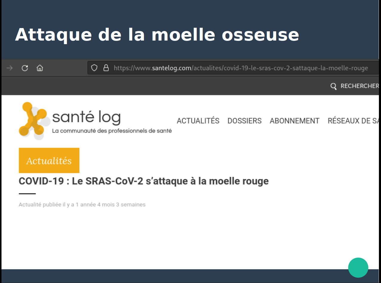

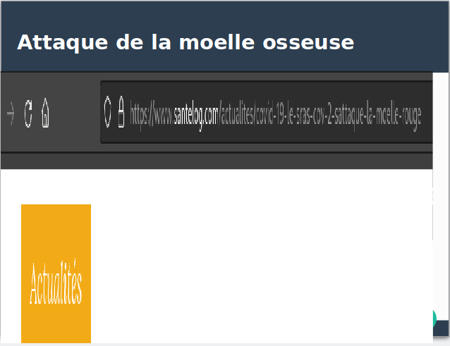

It's quite a few years that I install on old computers Q4OS, that people like, but for my usage, all my presentation made via LibreOffice Impress have pictures distorded.
I have noticed that concerns only pics that have been croped a lot.
Do you have an idea where the problem come from?

Thanks for the answer, but the image is correct when openned from XFCE or GNOME. Lots of crops are correctly viewed in q4OS, just the biggest are not well read.
So I don't know why the problem occurs only when I'm on Q4OS.
Here is an example :
So that means that I have to rework all problematic pics, that's not possible (more than 1000 slides in the presentation).
All are done with LibreOffice from Bookworm repository.

I can reproduce the same strange display: simply right-click on the image -> Original size.
So, in my opinion, there is definitely a problem with the copy of the image contained in your presentation. It can be related to its history, somewhere between screenshot and final integration into your presentation.
I also looked at the images of the Earth and Moon on slide 7 and they become oval at "original size".
