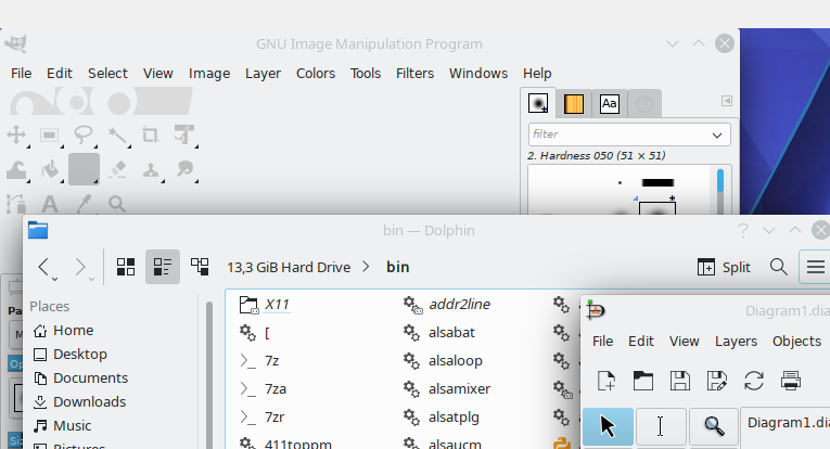

Re: Q4OS 4 Gemini stable released
I have already installed it!!  Everything works great and very fast.  My only issue is that the fonts appears to be tiny in some GTK applications such as Dia, Gimp,
Firefox (non -ESR)

itsoulos wrote:
... fonts appears to be tiny in some GTK applications such as Dia, Gimp, Firefox (non -ESR)
What desktop environment ? What installation media did you use ?
We are not able to reproduce the issue, GTK fonts for Dia and Gimp applications are the same size as the system font, see the image attached. Would you paste a screenshot here please ?

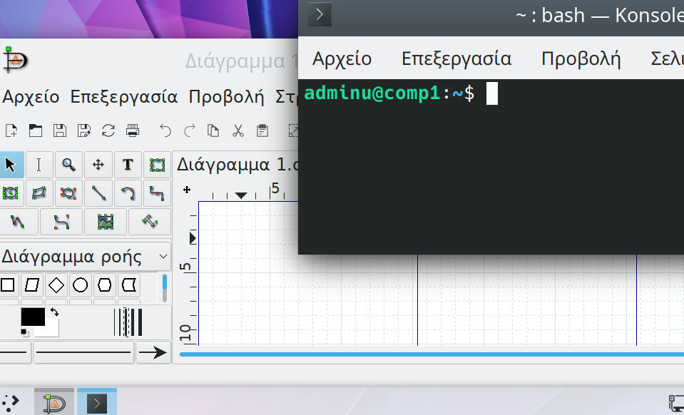

#10 2021-09-27 20:07
itsoulos
Registered: 2020-12-19
Posts: 94
No, the fonts in KDE apps have bigger size than that in GTK apps

@itsoulos
Did you configure screen scaling ? We have performed some investigations, but still not able to reproduce the issue quite exactly, see the image attached, so it seems to be hardware dependent. As we cannot investigate further, it would be really helpful, if you could confirm the same fonts display issue on vanilla Debian Bullseye on your hardware.
#14 2021-09-28 09:29
itsoulos
Posts: 94
@itsoulos
http://www.q4os.org/forum/qimg/qg0045.png
Yes I have enable screen scaling. I have the same problem with an installation of Q4OS on a Macbook Pro mid2014 with Retina Screen. I have installed MX Linux and Sparky Linux on the same machines, but I did not face the same problem as with Q4OS.

@itsoulos
You likely need to uninstall "xsettingsd" package and reboot. That should fix the issue.
$ sudo apt autoremove xsettingsd
In addition you may install "xsettings-kde" package:
$ sudo apt install xsettings-kde
and report back the result.
#22 2021-09-28 20:00
Upgraded both my present Gemini installs to 4.6.1 with no issues.
#23 2021-09-29 08:13
Posts: 6,248
Even more proper way would be moving the ".xsettingsd" config file, so you don't need to uninstall "xsettingsd" package:
$ mkdir -p $HOME/.configtde/xsettingsd/
$ mv $HOME/.xsettingsd $HOME/.configtde/xsettingsd/xsettingsd.conf
We are working on a fix.
