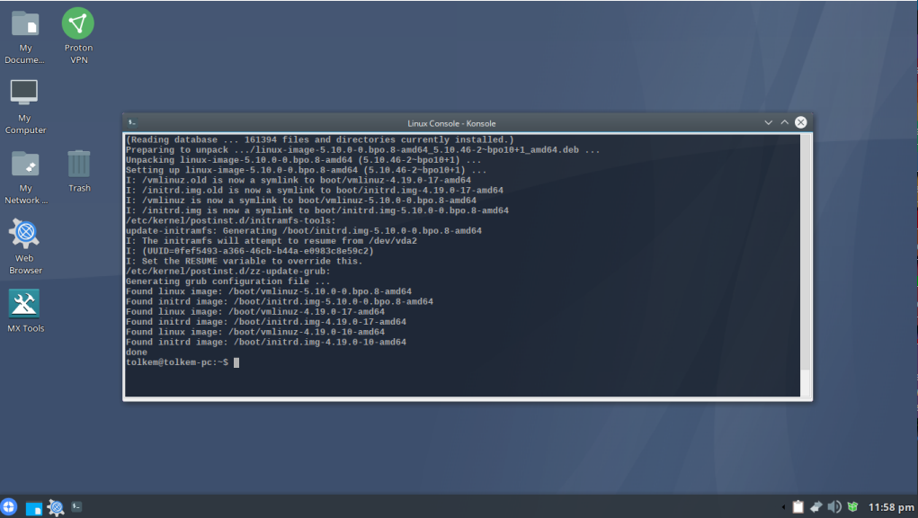

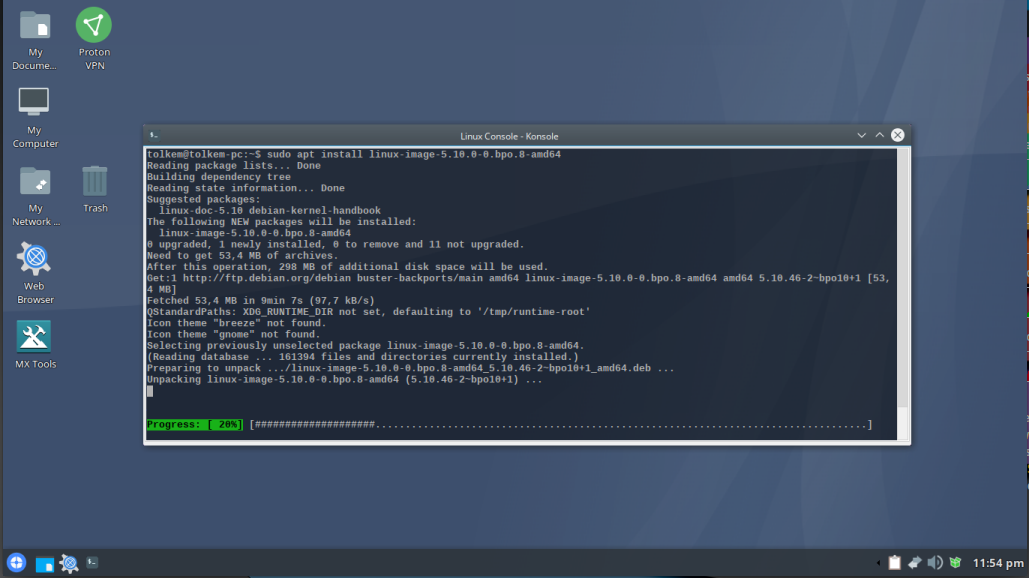

Too bad that didn't work, however, I just managed to install linux-image-5.10.0-0.bpo.8-amd64 in my VM running Q4OS Centaurus, though I didn't use the same method. This is how I did it:

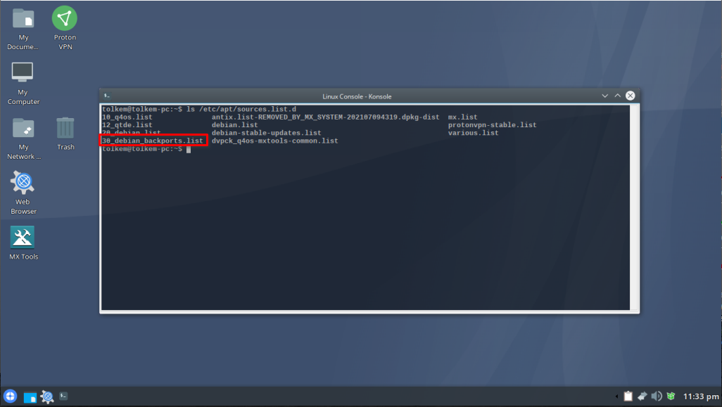

1. I booted up the VM, and launched Konsole, then I check for the debian-backports file located in /etc/apt/sources.list.d with `
$ ls  /etc/apt/sources.list.d
that revealed the file I needed to edit to enable backports 30_debian_backports.list
2, I edited the file with nano
sudo nano /etc/apt/sources.list.d/30_debian_backports.list
and uncommented the line starting with deb, that is, I removed the # symbol in front of it.
then I saved the changes by pressing Ctrl + o and hit Enter, then Ctrl + x to close nano.
3. I updated the sources
$ sudo apt update

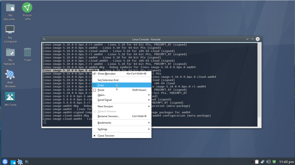

and searched in apt's repository for any matches in 'linux-image*'
$ apt-cache search 'linux-image*' | sort | less
once I found the one I was looking for, I selected it, right-clicked and copied its name
I pressed q to exit the search, and proceeded to install with
$ sudo apt install linux-image-5.10.0-0.bpo.8-amd64
I pasted the name I copied before here, and it did install without complains.

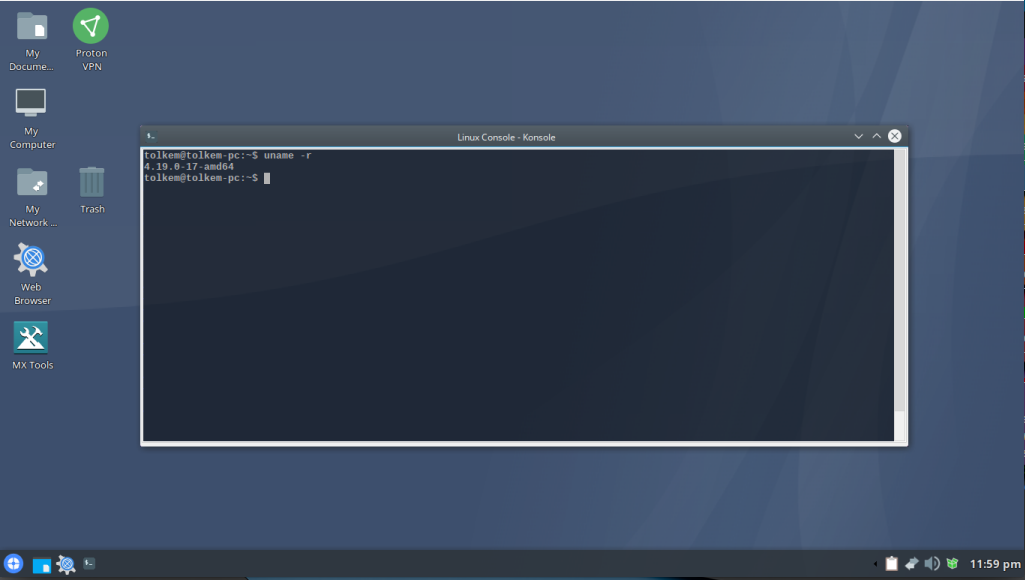

4. I checked the current kernel version before reboot
5. I checked the kernel again after reboot to confirm the new kernel was in use, and indeed it was.
So, there it is, you can try this and see if it works for you, and I can't see why it shouldn't. smile
