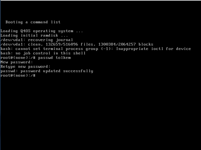

4. Hit Ctrl + x to save the changes and boot to a command line console
5. Now, type passwd followed by your username, and press Enter, for example, I did passwd tolkem
6. You'll be prompted to type in, and confirm your new password, do so
7. Once the password has been updated/restored successfully, type in sync and press Enter, then type in reboot -f and press Enter again
