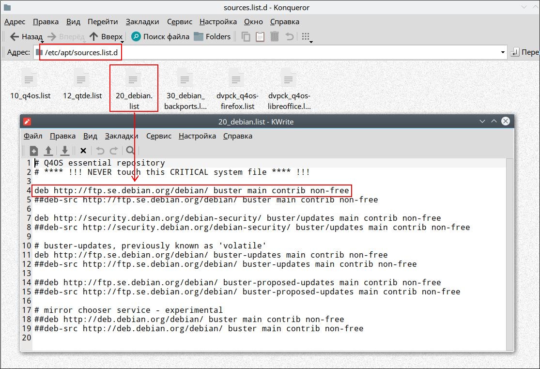

#2 2021-02-04 16:04
Posts: 681
Re: Missing network driver
This adapter should be merged into the kernel.
Unfortunately, I can not provide you with the exact steps, because I do not have this notebook. The only thing I can do, is to point you, where to find the solution.
You should do the rest by yourself.
There is an article, which explains how to enable support for WiFi devices based on Intel 2100, 2200 and 2915 chipsets on Debian systems: https://wiki.debian.org/ipw2200
Your adapter is in the list of supported devices and this is good news.
But Non-free firmware is required for both drivers.
Debian policy is to avoid any proprietary and non free packages, so that explains, why this package has not been installed.
One important note! The example is for Debian Jessie, but your Q4OS 3.10 is based on Debian Buster.
So follow these steps:
1. Open file /etc/apt/sources.list.d/20_debian.list. There should be a string, which I marked in red rectangle. See attachment 1.
2. Update the list of available packages.
In Konsole type sudo apt update
3. Install the firmware-ipw2x00 and wireless-tools packages.
In Konsile type sudo apt install firmware-ipw2x00 wireless-tools
You are required to accept the license agreement before the firmware is installed to your system.
4. As the driver may already be loaded, reinsert the relevant driver module to access installed firmware:
sudo modprobe -r ipw2200 ; sudo modprobe ipw2200
5. Reboot computer
6. Install Q4OS Network manager from Q4OS Software Centre, and configure your wireless network.
If you do not have internet at all (which is strange, you should have separate LAN adapter), you can try to download the firmware-ipw2x00 and wireless-tools using another PC, put them on your USB flash drive and install manually on your Thinkpad laptop, but without Internet connection they might not install, because of unmet dependencies.
You can manually download them using following links:
https://packages.debian.org/buster/firmware-ipw2x00
https://packages.debian.org/buster/wireless-tools
Then put them on your Flash drive, then copy to Thinkpads HDD, and in Konsole write: sudo apt install /path/to/your/firmware-ipw2x00.deb and sudo apt install /path/to/your/wireless-tools.deb
But keep in mind, that without Internet connection they might not install, because of unmet dependencies.
I have spent an hour for writing this article. Hope it helps.
