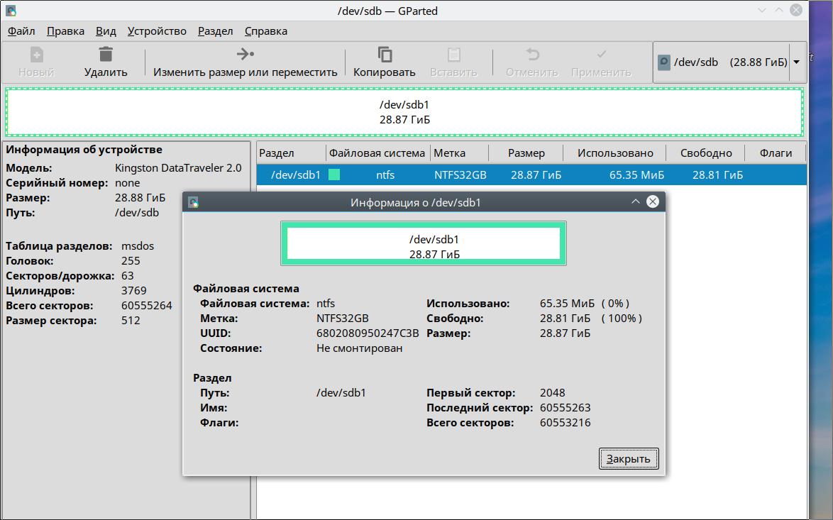

I have formatted one of my USB Flash drives to NTFS (Attachment 1).
And yes, this bug still happens with NTFS file system.

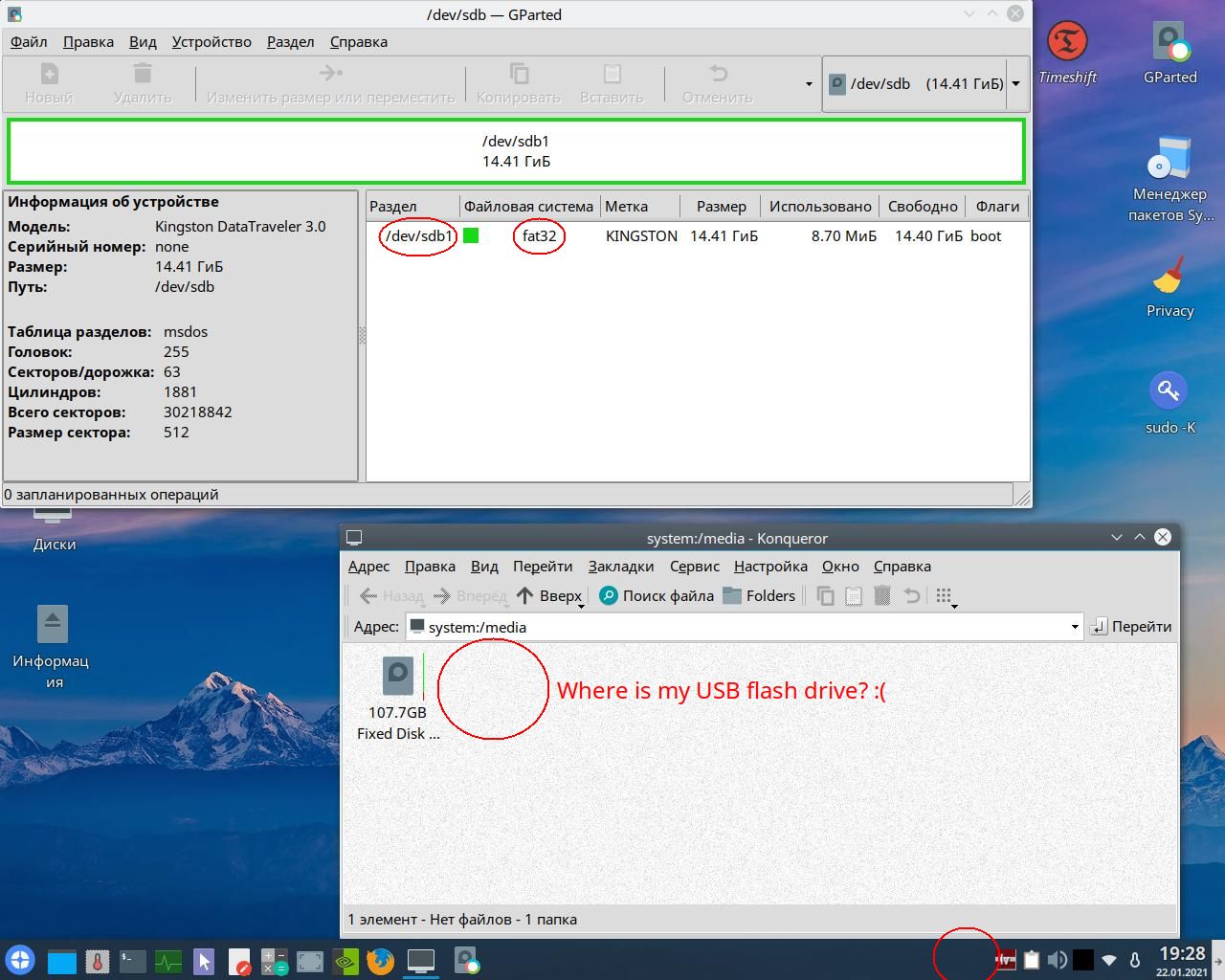

Update 2:
This bug happens with FAT32 formatted USB flash drive. (Attachment 2 in this post)

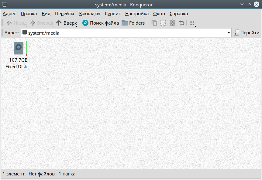

/system:/media is not a mount point. It is a some kind of address or link to place, where all attached disks are listed. I do not clearly understand, maybe Q4OSTeam explains better. You can access it if you click My Computer on Desktop, and then Storage Devices. See attachments.
I do not use custom mount points. Mount points are always /media/username/HDD_Name
"System" is not my user.
I mount HDD using Konqueror. I do not use Dolphin at all.

EXT4 is not exactly a "friendly removable file system" to use. Is the HDD the one with 107GB which reads as Fixed Disk in screenshot system_media.png? Are you sure that it is a removable disk?  Cause it looks to me that it is the main disk; the one Q4OS is installed in.

Is the HDD the one with 107GB which reads as Fixed Disk in screenshot system_media.png? Are you sure that it is a removable disk?  Cause it looks to me that it is the main disk; the one Q4OS is installed.
This disk is fixed disk. But system:/media also lists removable disks, like TRANSCEND1GB in attachment.

OK, I have formatted one of my USB Flash drives to NTFS (Attachment 1).
Also, I have noticed, that you do not even need to make something in GParted to trigger this bug.
Everything you need to do is:
1. Plug in USB Flash drive or USB HDD, the attached drive will be shown in system:/media, and in the taskbar. (Attachment 2)
2. Open GParted. Just open, do not do anything in GParted.
3. As soon as you open GParted, The attached drive icon disappears in system:/media and in taskbar! (Attachment 3)
I will correct my first post with new steps to reproduce.
Update 2:
This bug happens with FAT32 formatted USB flash drive. (Attachment 2 in first post)

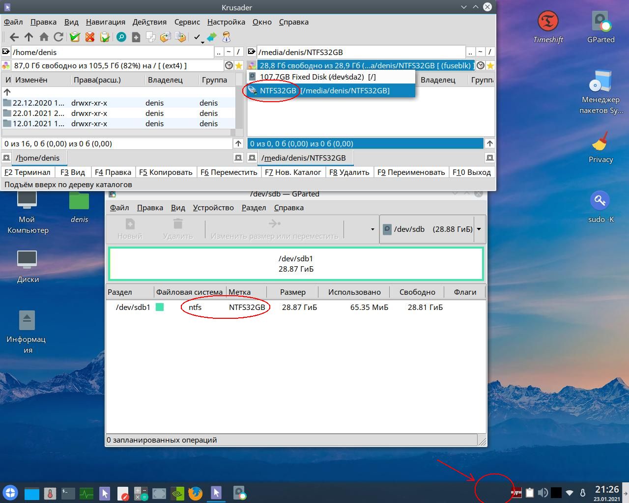

#17 2021-01-23 20:36
Posts: 637
Re: Removable disks in Konqueror
Tolkem wrote:
Have you checked in Krusader?
In Krusader I was able to mount and unmount USB drive after opening GParted. The drive icon does not disappears in Krusader, but still disappears in system:/media and taskbar. (Attachment 1).
Opening Konqueror and GParted from Konsole did not show any errors, but USB drive icons still disappear after opening GParted.
