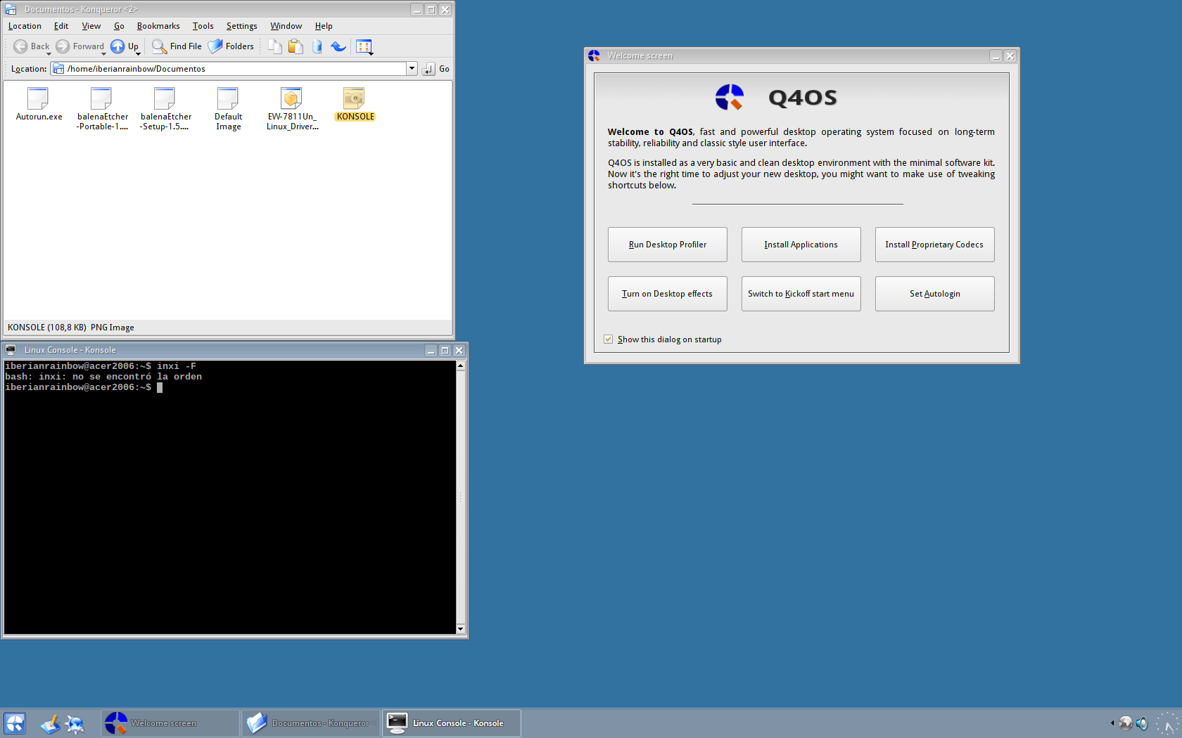

Hi bin,
Thanks for your reply,
I did what you asked my and this is the output...not promissing as says "order not found"...
See attached.
Regards.
David RG
#4 2021-01-17 06:32
Posts: 1,610
Re: Wireless not connecting
If you can get the machine on the web another way then you'll need to install inxi - I thought that they'd finally got round to including it in the ..........ah wait a bit you've used the 32 bit media. I don't think they've updated that with inxi.
However, if you can connect using the onboard ethernet then run
sudo apt install inxi
