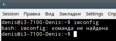

[Solved] Tool for managing wireless networks.
Which tool is responsible for managing wireless networks in Q4OS Centaurus? I was surprised, when I entered iwconfig, and Konsole showed me - command not found. hmm

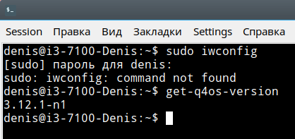

#4 2020-12-15 15:44
Posts: 637
Re: [Solved] Tool for managing wireless networks.
For some reason IDK, you need to use sudo with it:
$ sudo iwconfig
otherwise, you get the infamous
$ iwconfig
bash: iwconfig: command not found
Nope, that does not working too!
#5 2020-12-15 15:55
Posts: 5,037
"network-manager" is responsible, however you can anytime install "iwconfig" as well:
$ sudo apt install wireless-tools
#6 2020-12-15 20:41
Hmmm...maybe it isn't installed by default as q4osteam's post suggests, and I probably installed it time ago but don't remember doing it, either way, do as q4osteam says; install it first, then try again.
#7 2020-12-16 10:22
Posts: 637
After installing wireless-tools, [sudo iwconfig] started to work. Thank you for help.
