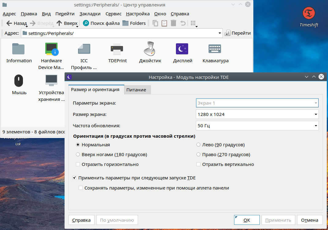

Monitor refresh rate.
How to change my monitor refresh rate to 60 or 75Hz? In trinity settings there is only 50Hz available (attachment), but I am sure, that my monitor supports 60Hz and 75Hz.

The drop-down isn't greyed out so are you sure there isn't another option there? Also the frequency might not be supported by your video card (or built-in graphics).

No, there is only two options - 50Hz and 51Hz. And yes, I am 100% sure, that my video card and my monitor fully support 60Hz and 75Hz. I was able to set such refresh frequencies on Linux Mint 18.

We can confirm, the TDE monitor settings utility sometimes shows incorrect refresh rate values, 50, 51, .. Hz. You can choose and set them from the drop down list, they match to the real proper values. It seems to be a Trinity bug, we will investigate and possibly report that.
