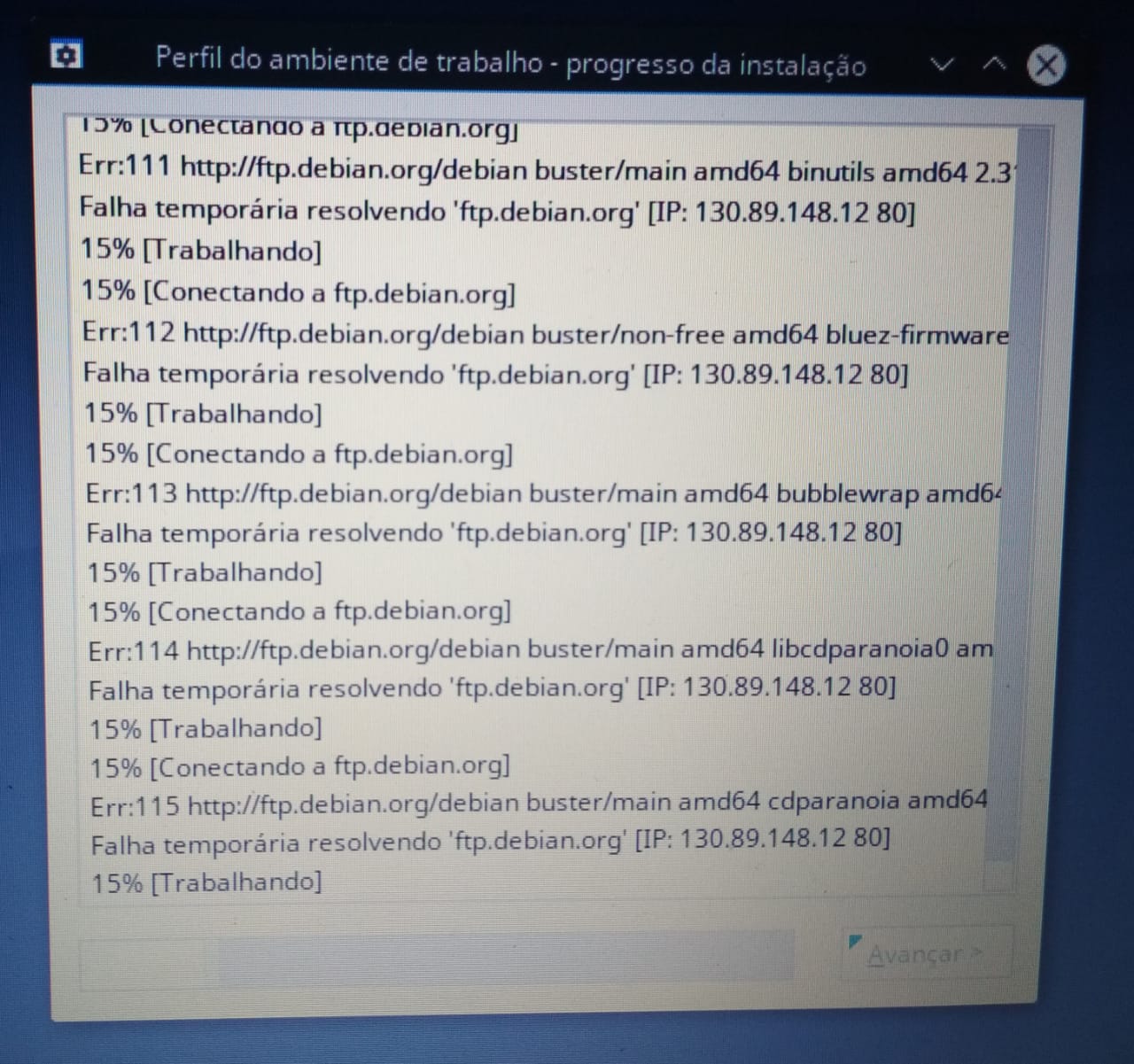

After a long time without doing a new Q4OS installation, I am having problems installing the Full Profile through the Software Center with "q4os-3.12-x64-instcd.r3.iso".
In fact, I believe it could be something in my connection, but I've tried everything and I can't solve it...
First, after a clean install, I couldn't even "apt-get update" or install the language pack via the desktop icon. I discovered that it was a DNS issue, I configured Google's DNS on my router (8.8.8.8 and 8.8.4.4) and I was able to install the language pack and run the "apt-get update" normally.
But the problem now is when I will install the Full Profile.
The installation starts normally, with good speed, but after some time it is as if the connection stops and is forever trying to connect with the frozen percentage, while displaying messages "Temporary failure resolving ftp.debian.org [IP 130.89.148.12 80]"... And the installation just doesn't go on...
Screen in attachment.
Does anyone have a suggestion?

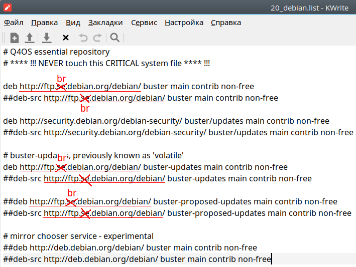

After fresh install, the q4osteam suggests to install desktop profile first, and then make another system tweaks. I think, it is a bit incorrect. When I install new Linux distro, I modify the default repository mirror to that, which works best for me.
So I would suggest you to change your repository mirror to Brasil repository (you live in Brasil right?).
You can do it by modifying /etc/apt/sources.list.d/20_debian.list file.
Open it as root (tdesu kwrite /etc/apt/sources.list.d/20_debian.list), and change all ftp.debian.org/debian strings to ftp.br.debian.org/debian/. See attachment.
Then do the same thing in /etc/apt/sources.list.d/30_debian_backports.list file.
ftp.br.debian.org/debian/ - Debian mirror in Brasil.
You can read more about Debian mirrors here: https://www.debian.org/mirror/list
After that reboot your computer.
After reboot in terminal check connection to mirror:
ping -c 50 ftp.br.debian.org
Ideally, the output should show 0% packet loss.
Finally type
sudo apt update
The repository indexes should be downloaded from ftp.br.debian.org
Brasil mirror works for me (attachment).
