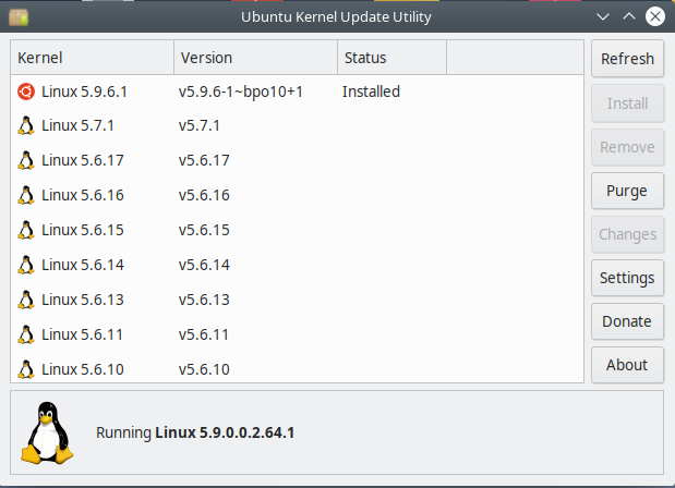

#17 2020-12-08 22:22
Tirso Medina
Registered: 2020-11-27
Posts: 18
Re: Problems with grub boot table
What is "linux-image-unsigned-5.4.45-050445-generic" ? How did you install that ? Please post the exact procedure.
The exact procedure was to install it through an application called Ukuu, which is a GUI for managing kernels, which builds a list of kernels available from the UBUNTU repository and shows it to the user so that they can decide which to install. I only installed it so that my system had more than one, to try to force Grub to let me choose a different one from the last one installed. (It only lets me use the last one installed).

#19 2020-12-08 22:51
Posts: 5,036
We don't know how "Ukuu" installs the kernel. Because Q4OS is based on Debian, you can ask Ukuu developers to properly register the kernel in Debian. What works in Debian usually works in Q4OS as well.
