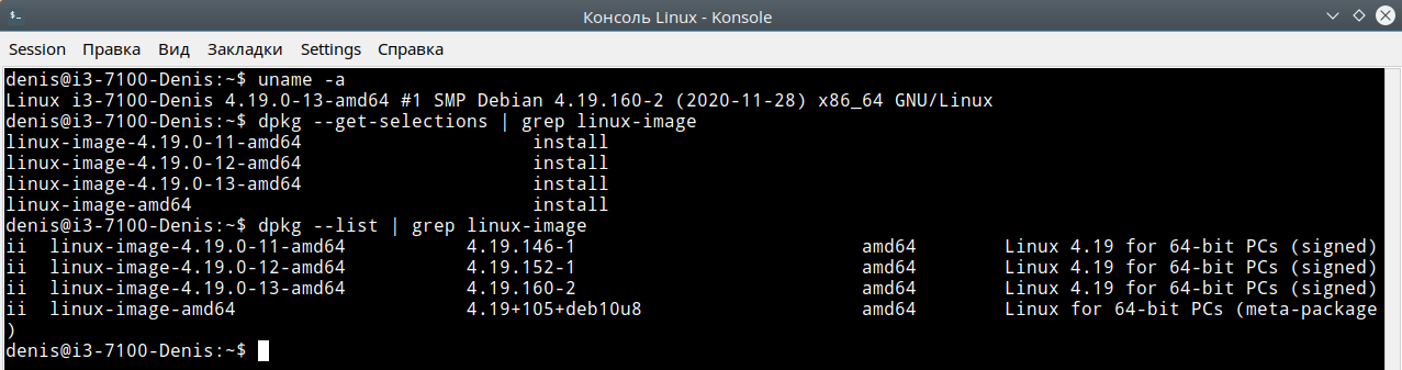

After some updates, I have three kernels installed on my Q4OS Centaurus (attachment).
How can I remove (purge completely) old unused kernels?
I am ashamed to admit it, but I still don't know how to do it.
Also, how can I hold kernel to prevent it to be auto-updated?

sudo apt autoremove does not removes kernels completely.
Also I want to know how to manually remove them. For example, I have kernels A, B, C. Kernel C is newest and active. How can I completely remove (purge) kernels A and B?
And how can I hold kernel C to prevent future updates of it?

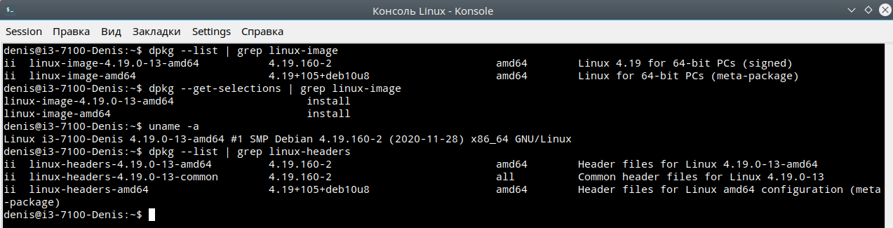

I have removed old kernels and their headers!
I use Timeshift and Clonezilla Live for system backups.
