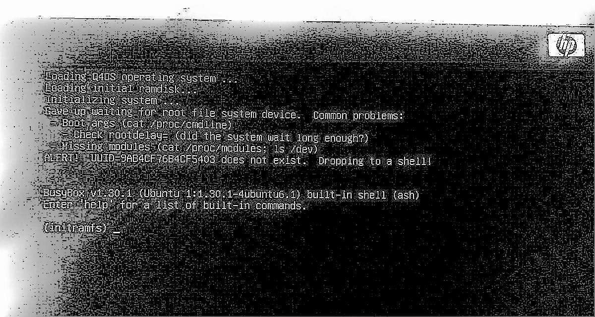

#85 2020-07-10 13:20
Posts: 276
Re: Ubuntu Quark 20.04
Sorry, bad news. It appeared to install alright even if it took it's time but then I was unable to boot it.
On the first reboot, I was booted straight into Quark, only to be shown the initramfs error in the image after a while.
Second time, after I rebooted, I was shown the regular Windows boot manager and after I chose Ubuntu Quark, I was shown a recognizable login manager, only I couldn't interact with it -- the first mouse click registered, apparently, but from then on I couldn't input anything, either via mouse or keyboard.
On the the 3rd reboot, I got the Windows boot manager again but when the Ubuntu Quark's option was chosen, I got the same initramfs error, so I gave up.
And sorry again for a laughable picture, the processing was meant to make readable a really bad phone photo.
initramfs error
#86 2020-07-10 14:44
Posts: 6,440
Thanks for the report. We can dual boot Quark and Windows fine here. Do you have UEFI BIOS ? Do you have secure boot switched on ?
#87 2020-07-10 16:11
Posts: 276
That's a negative on both cases on this particular laptop (a different one from the one previously posted).
What I do have is a somewhat peculiar drive geometry that never prevented me from running Windows setup Q4OS without issues...

#88 2020-07-10 18:30
Posts: 6,440
Your disk setup is fine, the filesystem within the loop virtual disk file looks to be corrupted. We have noticed possible buffering errors in the process of writing into the virtual loop device. This is specific for Ubuntu kernel, the Debian systems work flawlessly, so it could be the case. Anyway, it needs more investigation.
#89 2020-07-10 19:11
Posts: 276
From what I can gather, that would be consistent with what I have seen here. Back to vanilla Q4OS, then.
#90 2020-07-15 18:19
Posts: 276
Unfortunately, when I tried running 'q4os-winsetup.exe' to reset Q4OS Centaurus in a loop device, I got a similar error. Before my tests, Scorpion was running fine.
It looks like the app is hard-coding the UUID of the Windows boot device and once it reboots the setup gets confused when that device cannot be found anymore. Guess I'll try Wubiuefi with Ubuntu next.
#91 2020-07-15 19:15
Posts: 6,440
That started to look more like a hardware issue. We are running the Centaurus loop setup on a few devices including a virtual machine, all is running fine for several months now. The application doesn't hard-code UUID, it has no fixed place to hard-code it to.
Did anyone else encounter this issue ?
#92 2020-07-16 12:18
Posts: 276
Oh! Although the rig is functioning perfectly on Windows, I'll look deeper into it and tell if I find anything. sad
I only pointed at the UUID because errors explicitly mentioned it on both events...
#93 2020-07-16 13:22
Posts: 6,440
Not hardware issue, likely hardware related. It will be interesting to see the Wubiuefi setup, please post a result, if possible.
#94 2020-07-16 15:19
Posts: 6,440
If you would install Q4OS once again, the log file "/var/log/fstbootsrv.log" could help us to investigate the issue, as we are not able to reproduce it anyhow.
