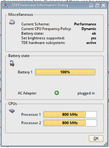

There is an AC plug symbol in the task bar. I have attached here what I get When I click on it. There is nothing there that can be set to my needs. I found TDEPowersave - Battery Monitor, in the menu in System but refuses to open.
Theresa

You don't need to reinstall anything. Simply click with the right mouse button to tdepowersave icon in the systemtray and run config dialog. Tdepowersave refuses to open from menu, as it's already running in the system tray.
