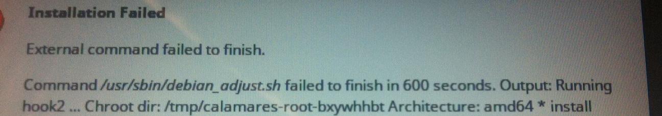

Gave this the good ol' college try again - tried a 3rd iso - q4os-3.9-x64.r1.iso, 931MB [12/17/19] fresh
download as of early this am - this time around the installer got stuck at ~  /usr/sbin/debian_adjust.sh
failed to finish in 600 seconds. ... as indicated at 65%  - it also trashed my grub/bootloader, which is
totally unacceptable - did a reburn, same result, I even tried two different USB sticks that I have been
using for eons, using multibootusb  ...  http://multibootusb.org ....
Nada, then burned the original 333MB [ d/d 12/04/17] TDE iso, which installed flawlessly into the same partition...

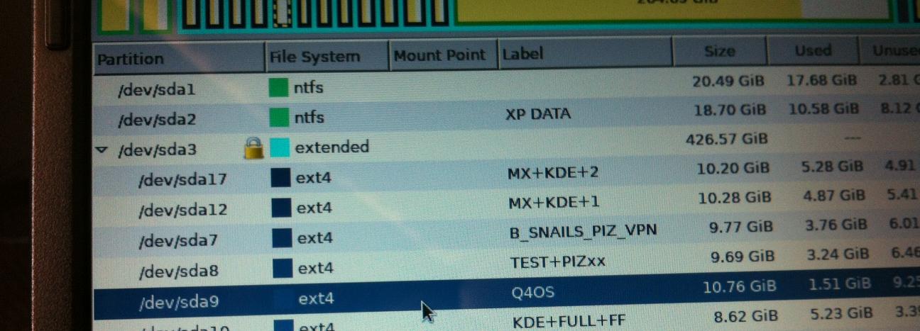

Same ol' Acer 5635G NB, with Intel dual core CPU, Nvidia GPU, 4GB RAM, 500GB Seagate HDD, et al, that
I use as a test-mule for all my distro/experimental work > 27 x partitions, it simply works flawlessly - 3GB,
8GB sticks

jackdanielsesq wrote:
The fact that this install didnt make it at all indicates, the iso was changed from my two previous downloads
The iso hasn't changed certainly. We ever publish any different iso images under a unique name. Where did you download it from ?
The right iso is:
sha1: 78aaa87bc78697c74cb03c51d4f17ce0ca1b0a50
MD5: 200ce33a04d89c88a0f62ab213b7b068
download: https://sourceforge.net/projects/q4os/files/stable/
If you would attach the log file "/tmp/q4hook2.log" of the failed installation, we may be able to check the log out.

You need to perform a fresh installation. As soon as the error occurs just close Calamares installer, grab the "/tmp/q4hook2.log" file and attach it here.
EDIT: You could attach other generated log files "/tmp/*.log" as well.

I have done >6 failed attempts at installing your iso - just installed my own iso of 1.5GB
[a full SOHO O/S] on #9 - the install took 6 min, grub/bootloader a lot longer >25 O/S,
partitions - do miss legacy-grub - as my iso also has DEB roots, why not point me to the
