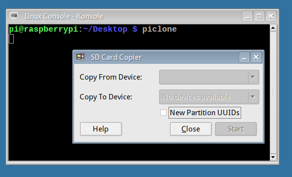

Installed piclone from terminal
It shows up on Synaptic as installed
When I try to run it via run command, it opens but buttons are grayed out and unresponsive ?

Maybe I'm missing something ? Nothing writes in terminal

Do you have any devices available to write to? the image you posted shows no devices available...
I think you will need to insert a usb stick or Sd Card reader (with Sd Card) for it to unlock the options. Also I'm not sure if it will work to copy the system that is in use, but I'm sure you will figure it out once you have another device plugged in.

Thank You !
I use it all the time .....
In Raspbian :
Opens with buttons white (not grayed)
It WILL copy system in use (that is the whole purpose)
I did have a USB Sd gizmo attached.
I think there is a way to read a log of what happens but it is beyond me sad
Is there perhaps an alternate way to do the same (clone Sd) with Q4OS
Can always "dd" (I think)

We have investigated the "piclone" issue and found its reason. The piclone binary requires "gvfs" utilities for a proper operation, however piclone package doesn't include the dependency. So we consider this issue as a kind of Raspbian bug. You only need to install "gvfs" package for piclone to run properly, just run in terminal:
$ sudo apt install gvfs
