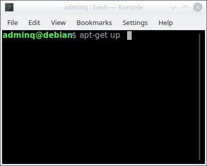

I've gone back over how I get there and it looks like it is triggered when setting anti-aliasing. I normally run with RGB Slight.
Attached screenshots show with default font after using View>Enlarge Font to make it easier to see.  It is the same at default size.
The gap after the text just happens - as soon as the next key is pressed the letter is in the right place, but the gap after is still there. Can be disconcerting.
