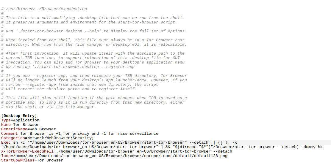

I've inserted the desktop file and you can see it conforms to the 'desktop entry specifications'.

You actually inserted a picture of your .desktop file, the actual file would have been better, I might be able to copy it but the Exec line seems (to me) to be overly complicated and may be causing a problem but I could not test it without having to use my own interpretation of a graphic, I will download tor in a VM later today to see what happens.
