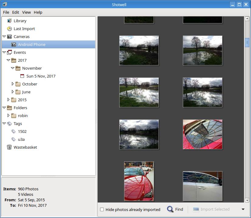

Hi Mazza - you're not alone! Different phones cause different problems. My old Nokia 5800 no probs, HTC 510 and Samsung A3 - nightmare!
When you plug in the phone it probably flashes up on the phone screen and may give you an option for Mass Storage or MPT or similar. If so go for Mass Storage - it may appear as a drive.
The other option I use is to install mtp-tools and gvfs-backends via synaptic and then install Shotwell.
Shotwell is a good picture viewer/organiser, but best of all, it will easily import pics from an Android phone. It takes  a little getting used to in how it imports into your Pictures folder, but once you've got them that's just organisation.
