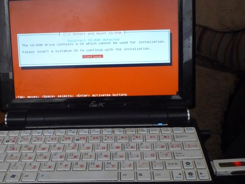

Installer stops when incorrectly detects USB stick as a CDROM drive.
I was trying to install it (custom install), when it hit a snag:  it presumed that my USB stick was a CDROM drive (yet the computer doesn't even have one).
This is with the latest version of ISO (as of this writing) q4os-2.4-i386-instcd.r2 , and the md5 checked out.
The computer is an ASUS eeePC 1000he, with Atom N280, 2GB of RAM, 1024x600 graphics(physical, with 1024x768 logical with panning).
Specs:  https://www.asus.com/ca-en/Laptops/Eee_ … fications/
I'll attach a photos of where it went wrong.  I tried ignoring the error and moving onto the next step... no dice.
Is this because the image (as the filename suggests) is for CD/DVD only, and not USB?
Please, if technical stuff/programming can be avoided, that would be very much appreciated.
I'm hoping for an ISO with a fixed installer (preferably), or a user-friendly solution.

#2 2017-10-31 16:33
Re: Installer stops when incorrectly detects USB stick as a CDROM drive.
You could try the live installer, it will allow easier (IMO) custom installation. The download page has images for 32 bit (591mb) or 64 bit (606Mb) and is what I always use. This also allows you to test the hardware compatibility and will allow you to check errors (if they occur) more easily.
You can also install software while in the live session so for instance you could install inxi and gather hardware configuration information for troubleshooting.
Agree with Dai as Ive seen this before, the live cd youll find easier to use.
Thank you, that is the first I tried, but it wouldn't boot.
I suspect that it's because in the filename, it is labelled as PAE,
and perhaps the Atom is a non-pae?

Correction:
this time I tried Mint's USBimagewriter, and 686-live is booting.
Trying it now.
