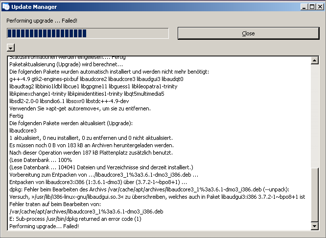

As having installed 1.8.2 i decided do get the update manager yesterday (to get the update of 1.8.3?).
At the end of the day i closed every single application and started the updater, but this ends up everytime at the error 100 for the libaudcore3 - shown as attached.
Re-loging in or even restarting the pc before  didn't change anyhing.

I'm not exactly sure what the error is (my translation skills are poor), but I would try these commands in a terminal to "clean up" apt
sudo apt-get update
Just to update the apt database
sudo apt-get -f install
this should fix any unresolved dependency issue by either installing or removing problem packages. After this I would reboot (not always necessary but it's a habit of mine) and then try update manager again to see if everything works ok now.

It's about conflicting packages from backports and deb-multimedia repository. You need to proceed following in terminal:
$ sudo apt-get autoremove libaudgui3
$ sudo apt-get install -f
$ sudo apt-get dist-upgrade

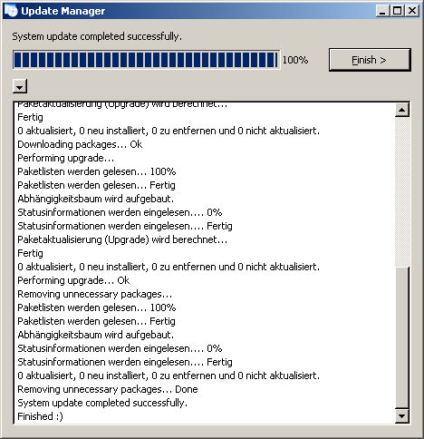

Thanks Bin & the Team. i did both:
sudo apt-get update
it recommended me to do a
and it removed a package like g+4.9 (or so) and some other...

But now i'm waiting for the update-nofier (in the task bar) since 20 minutes, it doesn't po up no more!?
Exists a possibility to start it directly?

Yes, there are probably no more updates, so the notifier is hidden. You can still run updater directly this way:
$ /opt/program_files/q4os-update-manager/bin/updatemgr.exu

Thanks again, indeed, the manual intervention solved that obviously.
