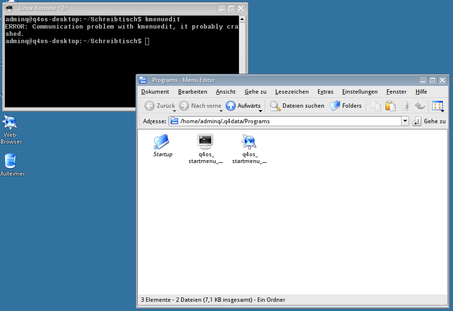

I'm very puzzled by the new menu edit process.
On the previous releases the MenuEdit launched a pretty familiar menu editor - the new one is strange - it just provides a Konq window headed:-
/home/myuser/.q4data/Programs/
You are going to edit Start Menu.
Start menu structure consists of two logical parts mixed, the system global and user part. You can edit, delete and add custom menu entries for the user part only, global menu entries are not visible in the MenuEditor.
You will be able to create new custom submenus/folders structure and fill it with desired menu entries. You can create new shortcuts using right mouse click, or drag&drop icons from start menu or desktop into the MenuEditor window.
Newly created items will appear in the start menu after closing the MenuEditor window.
Click "Ok" button to show the MenuEditor window.

Running from Konsole we get
robin@flopsie:~$ kmenuedit
ERROR: Communication problem with kmenuedit, it probably crashed.
This produces the symptoms described above

No matter which menu system I select I still get the same result - none of which is the old style menu editor I'm afraid.
So, it is a bug.
If you select Q4OS menu structure (default), see picture,
and run kmenuedit from terminal, the correct result should look like this:
If you will select 'by Categories' menu structure:
and run kmenuedit from terminal, the correct result:

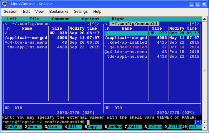

Unfortunately, we are not able to reproduce the issue you have described. Please, select 'by Categories' menu structure from Welcome screen and post output of the command:
$ ls -la $HOME/.config/menus/
for us to analyze.

Hi
The problem seems to stem from the fact that on my system the Menu Structure options are all greyed out and not accessible.
Here's the output you requested
robin@flopsie:~$ ls -la $HOME/.config/menus/
total 28
drwxr-xr-x  3 robin robin 4096 May 11 06:21 .
drwxr-xr-x 20 robin robin 4096 Sep 19 16:50 ..
drwxr-xr-x  2 robin robin 4096 May 11 07:07 applications-merged
-rw-r--r--  1 robin robin 4435 Sep 22  2015 .kde4-applications.menu.disabled
lrwxrwxrwx  1 robin robin   37 Oct 14  2014 .q4-kde4-applications.menu.disabled -> /etc/xdg/menus/kde4-applications.menu
lrwxrwxrwx  1 robin robin   48 Feb 15  2015 q4-tde-applications.menu -> /opt/trinity/etc/xdg/menus/tde-applications.menu
-rw-r--r--  1 robin robin 4438 Sep 22  2015 tde-applications.menu
I have trimmed the contents a bit to see if that made any difference but it does not - see below.
