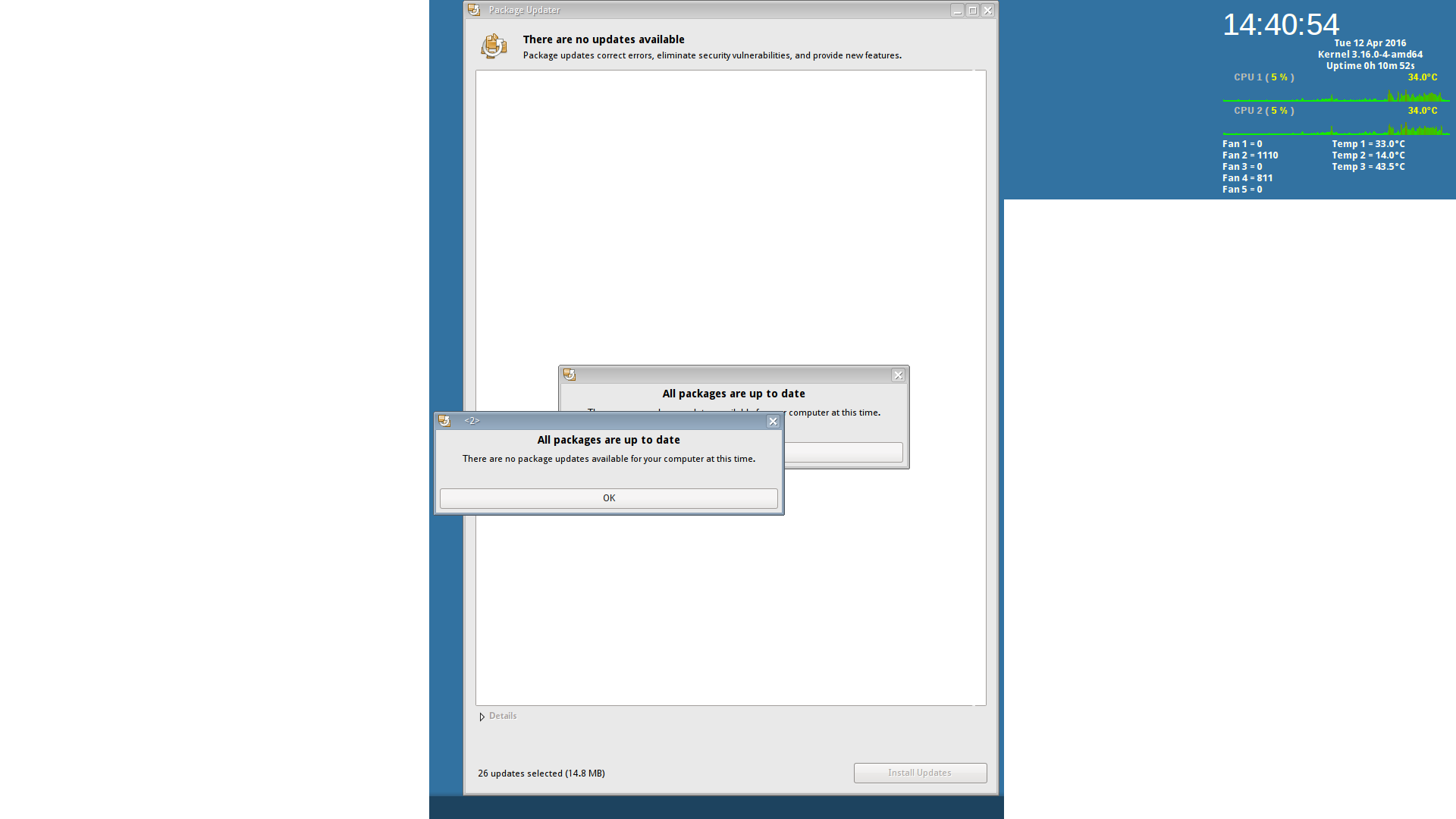

#29 2016-04-09 00:12
Re: Update manager two confirmation boxes when finished
I'm pretty sure that this software updater is unique to Q4os, so I would say it must be part of the Q4os package.
And I would not have been bothered by your first few posts regarding not seeing the issue, but the fact that you have 17 posts (to date) in this thread mainly saying it doesn't matter it's only you it affects, and use synaptic instead, that bothers me.
And even now you think an issue that could cause the user to think the OS is somehow "broken" or not working properly should almost be disregarded in favour of using synaptic, which it has been said in this forum is not particularly user friendly to new users.
I am grateful to the devs for the work they are doing on this issue, and although it is not a big problem it is one that could do with being remedied. Like I said in my original post it only caused me a problem as I could not close the updater, which if it happened to a user with less experience could be quite worrying and could cause them to find an alternative OS.
I installed from q4os live-cd 1.4.9, then installed language and full desktop profile on restart. installed proprietary codecs (the only sure fire way I know to get updates as it opens the deb-multimedia repository). ran sudo apt-get update rebooted and waited for the systray icon to pop up and launched from there.

We can definitely confirm the bug, thanks to Dai_trying's assistance. It's not Q4OS specific, but Debian related in general. We are able to trigger it on a clean Debian Jessie installation with XFCE4 desktop, with no Q4OS specific packages included. The exact steps to reproduce the issue on Debian Jessie:
- clean install of Debian Jessie, no desktop environment
- apt-get update ; apt-get dist-upgrade
- apt-get install xfce4
- apt-get install htop gnome-packagekit lightdm
- dpkg -i htop_0.0.1-r1_all.deb (we have created the fake 'htop' package to fire-up the package upgrade, attached below)
- reboot
- login into XFCE4 desktop and run in terminal as a user:
$ gpk-update-viewer
- package updater window will appear
- let updater to upgrade the 'htop' package
- two confirmation dialogs arise, the same as in Q4OS
We will report this at the Debian bugtracker.
We have created the fake 'htop' package to simulate package upgrade as described above, the package is attached here for those who want to play with.

I have just scrutinized a recorded session and the update manager is updating and loading the cache twice at the end of updates, but the dialogs only come up when there are no more updates available, in fact the cache is only loaded once when there are more updates available. I have attached a small video clip showing what I mean.
crop.mkv

Ok I found a solution, kinda. I inserted the line
ignore_updates_changed = TRUE;
at line 3009 in gpk-update-viewer.c just before
gpk_update_viewer_get_new_update_array ();
recompiled and everything worked properly!!
I have not gone through the entire code to see what effect this will have on anything else, but If it causes a problem somewhere else it could be set again easy enough.
I used the gnome-packagekit-gnome-3.14 source as I could not get the latest version to compile as version of gtk was too low, and I think that is the version we are currently using anyway.
