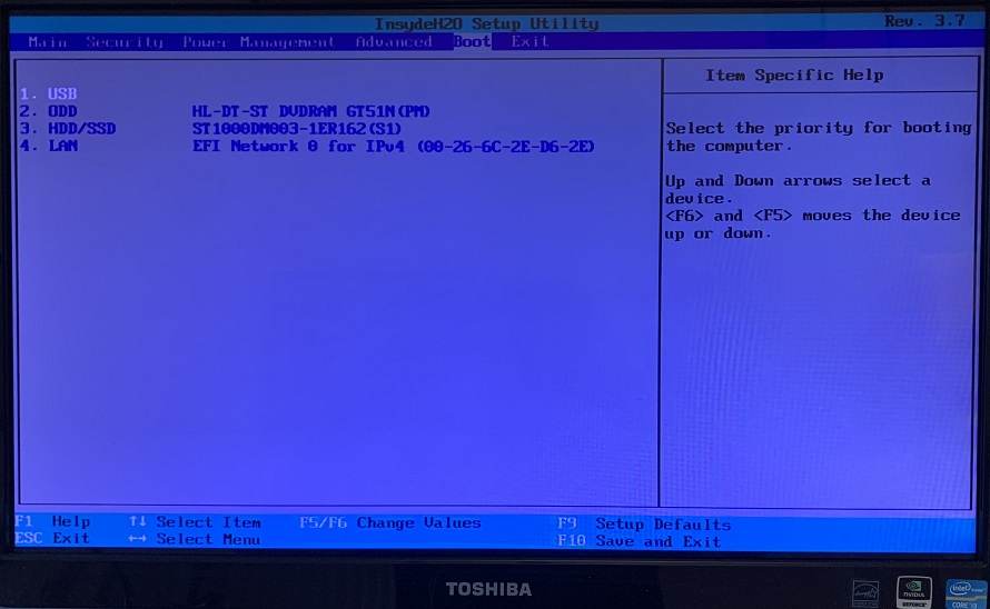

#29 2025-12-28 20:16
digbyd11
Registered: 2025-11-24
Posts: 30
Re: Set up duel boot Win 10 Q4OS does not register in boot menu
Attached boot screen
I had assumed that the Q4OS option would have come up as a second option in the top half of the boot screen but does not seem to be the case.
Machine spec is following image post

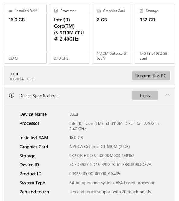

#31 2025-12-28 20:18
digbyd11
Posts: 30
Machine spec is attached

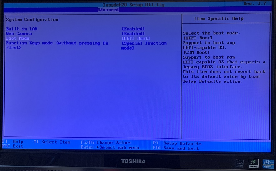

#33 2025-12-29 14:11
digbyd11
Posts: 30
Hi I will send 3 posts, one for each of the images.
This first one contains another copy of machine spec from which you will see that the machine is a TOSHIBA LX830.  The rest of the spec is included in this image.
The second post will have Bios1 image attached from which you will se that there is no EFi option.
The third post will have Bios2 image from the advanced settings and you will se that UEFI boot is enabled.

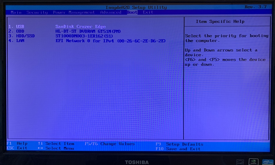

Interestingly you will see that in Bios1 the USB listing is blank, this is because I do not have any bootable media plugged into any USB.  However if I do plug in a bootable USB, for example I have MXLIVE on a USB stick, then the USB boot item detects this  and has the device listed and I can boot the MXLIVE system.  I have tried to do the same with Q4OS Live boot but this does not register and the USB option remains blank.  Do not know if this is part of the current problem.

#34 2025-12-29 14:12
digbyd11
Posts: 30
Regards
#35 2025-12-29 14:13
digbyd11
Posts: 30
Regards

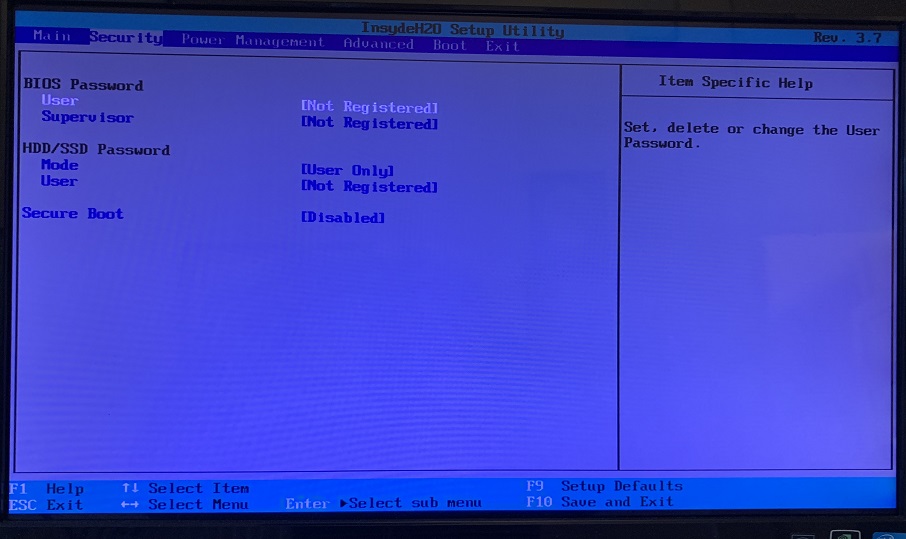

#37 2025-12-29 14:49
Posts: 6,107
In the "Bios1.jpg" we see a second menu item "Security". What if you open this submenu, post screenshot please.

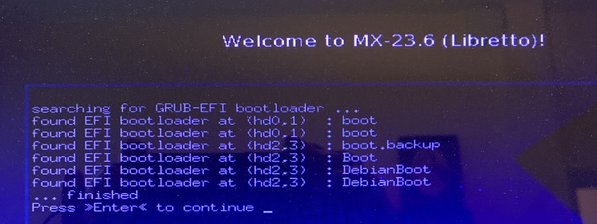

#38 2025-12-29 16:13
digbyd11
Posts: 30
Hi 3 posts again with the following.
In this one the Security image as requested.
Second one is Bios1a which shows the USB entry with a live distro loaded.
Third one is GRUB EFi which I am able to call up with the MXLIVE distro booted.
Regards
#39 2025-12-29 16:14
digbyd11
Posts: 30
Regards
#40 2025-12-29 16:14
digbyd11
Posts: 30
Regards
#41 2025-12-29 17:33
Posts: 6,107
Well, the Debian/Q4OS Efi record exists, see "DebianBoot" entry on "GRUB EFi.JPG". We only need to enforce BIOS to load this record on startup.
We would try:
- Enable secure boot
- Upgrade BIOS firmware
#42 2025-12-29 19:04
digbyd11
Posts: 30
Hi
Done that, BIOS is up to date and enabling secure boot changes nothing.
Like you I noticed that the EFi record exists but for some reason Windows Boot will not accept it.
Regards
