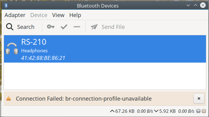

#64 2024-03-23 18:56
NoMoreWindows
Registered: 2024-01-03
Posts: 65
Re: Q4OS 5 for Raspberry Pi
On the current installation with test release 3 I get an error connection bluetooth devices. I think I remember it working with test release 2.
See attached screenshot.
Apart from that I've been using it for my daily activities, most frustrating is internet browser lagging (you can do it, but you always think "I wish I was on my regular PC"). Everything else works well enough although you shouldn't do many things simultaneously (like playing a video and editing a large text in LibreOffice).
Sometimes when doing stupid things the system can hang completely forcing you to power off/on. Probably  that's the same with Pi OS. (Happened to me 2x now with Q4OS.)

On the current installation with test release 3 I get an error connection bluetooth devices. I think I remember it working with test release 2. ... See attached screenshot.
Yes, we can confirm some missing bluetooth packages, please install them from repositories:
$ sudo apt install libspa-0.2-bluetooth pulseaudio-module-bluetooth
and report back the result.
Did this + rebooted and that fixed it.
I tried also from clean test release 3 and only added blueman. That also worked. So it looks installing the full profile or some other things I did afterwards broke the BlueTooth configuration.

Some issues remaining when I work with test version 3 (Pi 4 4GB from USB 3.0 stick):
BT problem surfaced again, removed blueman and installed again, that fixed it again.
